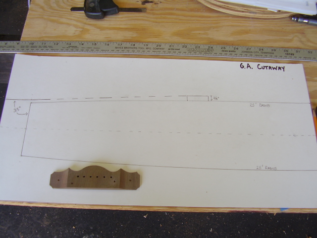

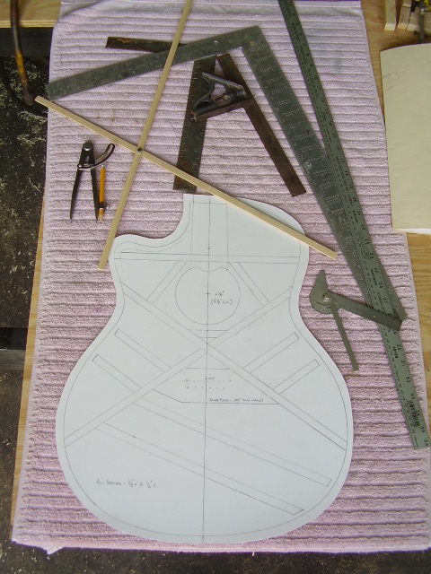

I used another guitar for the basic design of this project so I never had a blueprint or plan to work from. I've basically just made things work out as I went and kept a log of all specs for future reference. With that in mind, I figured it was about time I sat down and drafted out a bracing design. In the process, I decided to draft out a side view as well so I could go ahead and determine neck angle plus I was curious to see how the fretboard extension would work out in conjunction with the 25' top radius. Neck angle worked out to be 3.5 degrees and the fretboard extension will require very little work for a final fit. I also went ahead and made a couple of bridges from black walnut.

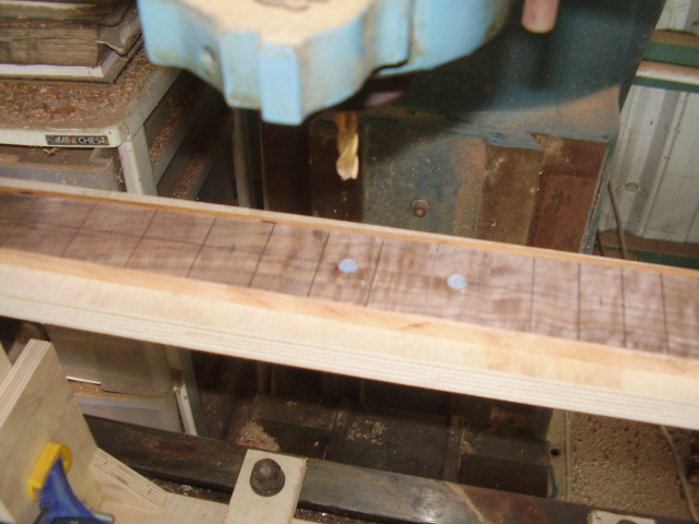

Installed inlay dots on both fretboards and then radiused using a swing fixture on the vertical mill.

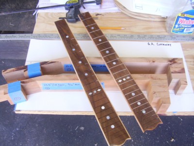

Cut neck angle on both neck blanks. A shot of both blanks along with both fretboards.

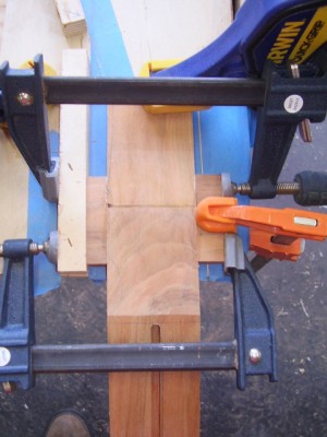

Glued extensions onto both headstocks.

Both necks with fretboards glued.......ready for final shaping and contouring.

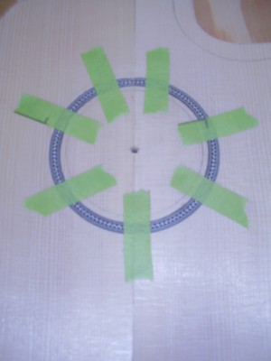

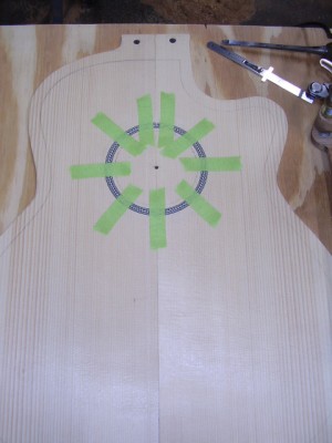

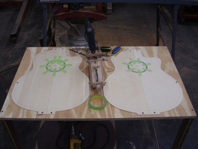

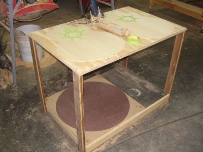

Well I made a little progress today. I got the 2nd top thicknessed and joined and then got both of them cutout to rough shape and ready for rosettes. I use the top of my go-bar deck as a work surface to do rosette work.
Eddie McRae
Posts: 153
Location: Woodbury, GA USA
Re: $100 Local Materials Challenge, Eddie McRae, Grand Auditorium Cutaway Acoustic
Post by Eddie McRae »
A few more pics of the tops and herringbone rosettes.....

I'm at a point here where I wouldn't mind a little input regarding the top bracing. I used another guitar that I own as the basic guideline to make all my templates and forms and such for this bodystyle. It's been one of my favorite guitars for over 20 years and has withstood the test of time as well as outperformed almost every high-end acoustic that I've owned including too many Ovations, 4 Guilds, and a Martin. I also used it when laying out the bracing pattern for this build as best I could along with using pics of Taylor's X14CE bracing design. The bracing in my existing guitar is not scalloped. So, that is my question. "To Scallop or Not To Scallop?"
Hmmmm...you might get several different opinions. So I'd ask you, have you made a guitar with scalloped bracing before? If I had to make this choice I would just take all that I knew about all the different bracing patterns that I had tried and what they sound like, and decide which direction I want this guitar to lean toward. Then design and go from there to best get that tone and the best guitar out of it.
Eddie McRae
Posts: 153
Yes I've built with scalloped bracing but it's never been in a comparative situation. In other words, I didn't have another identical guitar with unscalloped bracing to compare it against. It's always been my train of thought that unscalloped would provide a more balanced tone and that scalloped would let more low end come through. I may be wrong with that line of thinking though. At any rate, it occurred to me, this is the perfect "laboratory" situation for me. Since these guitars will be identical in every way, I think I'll scallop one and leave one unscallopped and compare the two when done.
Good plan! That's what I'd do too. I feel that the two patterns do have a different tones but I wouldn't want to try and describe it.
