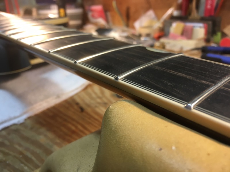

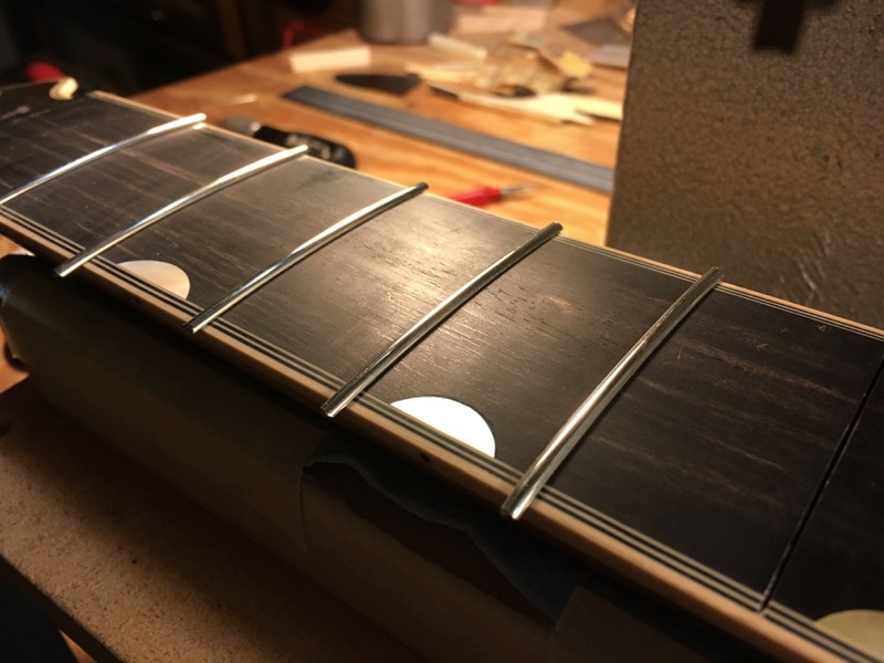

I am using the wide and tall Stew-Mac #154. It matches the wire that was originally on this 7-string, and is what the client wanted.
I don't know why, Mario, but I have sometimes struggled a bit with getting fretwire fully seated. Just about any fretwire pressed into a .023" slot is just too tight of a fit in my opinion. So I came up with the approach to widen the slot with a tapered dremel bit that has a maximum width of about .027". But that is a bit overkill and I have worried if it is really secure enough. I thought I would try the approach of removing a bit of the fret barb. So far, I like the results.
Keep in mind that I am installing frets in a board already glued to the neck. Also, this is an archtop so I don't have the ability to use a fret buck under the fretboard extension. I need to be able to press these frets in pretty easily.

The airport finally opened up yesterday and I got my Jescar fretwire in. It looks good. The tang measures about .022" thick. It is going in with just the right amount of pressure. Thanks again David.
I will probably still need to use my fret barber on the fretboard extension.
- Posts: 3249
Re: Burns Gear-O-Matic Truss Rod
Trimming the fretwire down for the fingerboard extension worked out great. It tapped in with the right amount of force. Not too much and not too little. I am happy with the Jescar and the way it turned out.

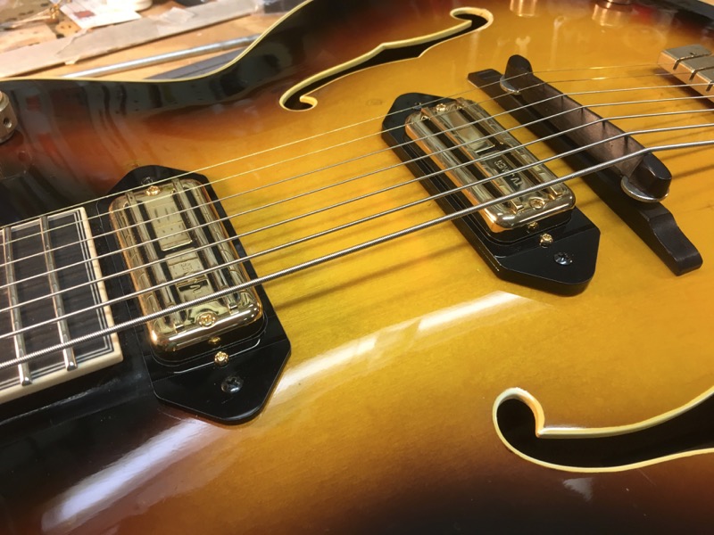

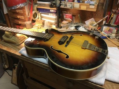

In order to bring completion to this project here are photos of the finished repair.
Installed new TV Jones Supertron pickups and wiring harness which includes a tone selector switch. These are blade pickups which works with the string spacing of the seven strings.
