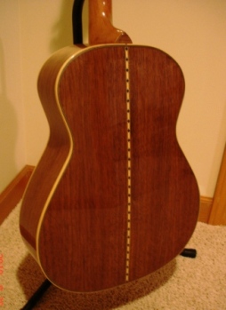

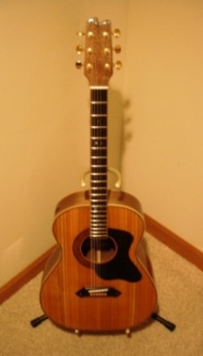

Have not built a hardwood topped guitar but have an Alverez-Yairi all-koa 6-string. Great acoustic-electric sound but lower volume and less bass acoustically. On the reclaimed wood thread here, the photos show a build with left-over walnut from furniture work and cedar from the hardware store scrap bin. I did buy the fretboard and bridge blank. Everything else is a "leftover" from furniture projects. Great-sounding guitar and great volume.
