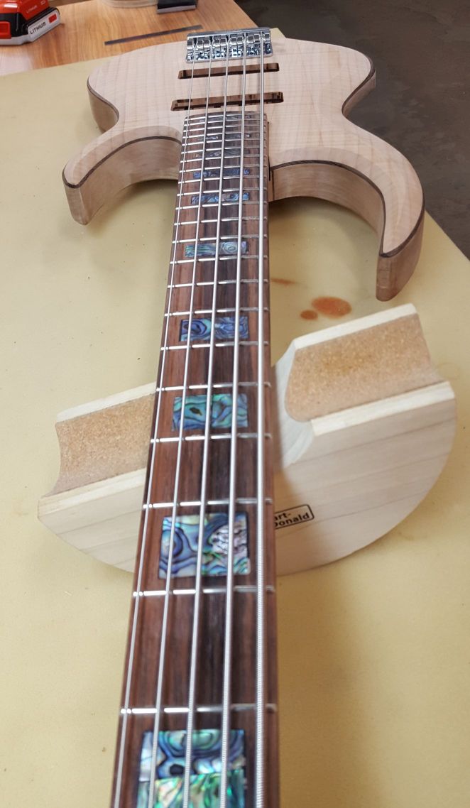

After finishing the routing for the inlay, I radiused the finger board to a 16 inch radius. I had to make a new radius cutter for my jig, so that took me a bit longer.
I cut the extra wood off the sides, and used my template to final shape it to the neck.
After that I epoxied the inlay into the fret board. I filed and sanded the corners off to match the radius, drilled the access hole for the truss rod, installed the rod, and then glued the fret board onto the neck.
Here it is in the clamps. There is a neck in there somewhere....
Ah! Here it is. More sanding and then oil the fret board. The epoxy was colored to match the wood once it is oiled.

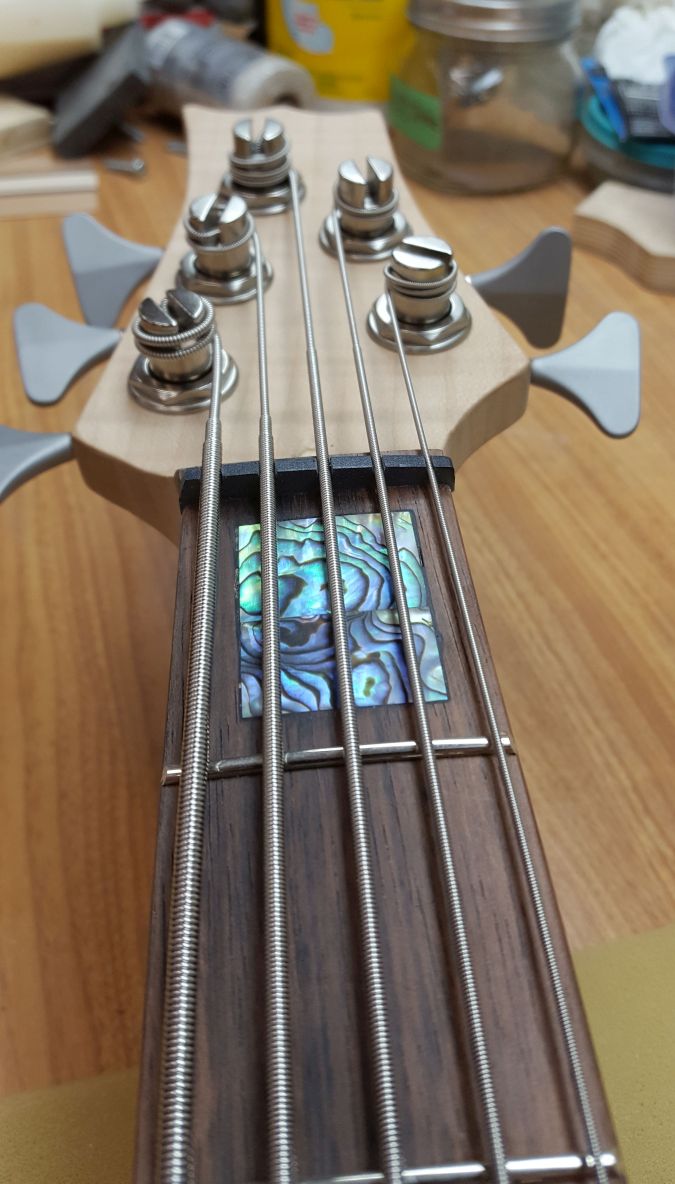

I was unaware that the block inlay in paua abalone would come in two pieces for each block. It made the inlay job a bit harder.
I also have to shape the end of the fret board to match the curve of the headstock at the nut end, and shape the base end to make it look better.
