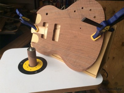

I'm going to make a jig to hold the guitar while I sand the bevels on my spindle sander.

You're gonna have to post pictures of this jig, cause that sounds criz-zazy.

My jig idea is to clamp the body at a certain angle and run the body against the sanding drum while the jig ensures a fixed angle.
I'll do a test run for sure, not certain if I'll get the intended result.

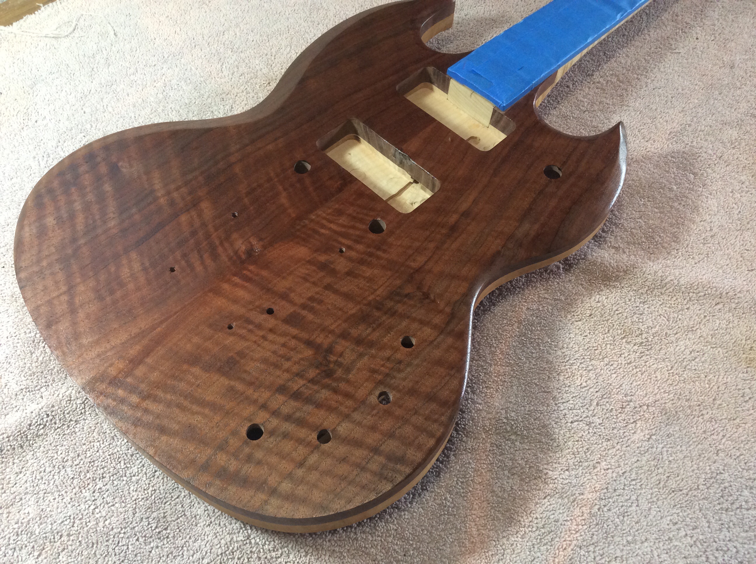

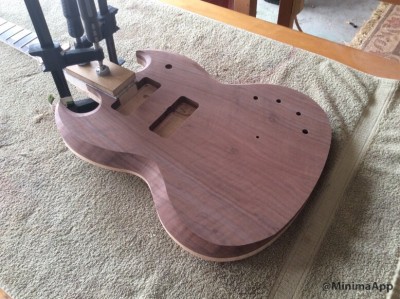

Made a cool jig to sand the bevels.
Dan
Posts: 585
Re: Making me one of them SG guitars
Nice Dan!
How bout that. It turned out pretty good. I like how the bevel is all on one plane and doesn't connect at the tail.

I really like the simplicity of the jig Dan.

I use my spindle sander for quite a number of tasks in an electric guitar build.
That, is a cool way to sand that bevel in.
I have a jig similar to yours that I use with the band saw, for cutting belly and forearm cuts. You have just given me another use for it!
Posts: 3249
Does this cut fairly smoothly or is there a tendency for hollows and bumps?

Barry Daniels wrote:Does this cut fairly smoothly or is there a tendency for hollows and bumps?
Barry,
It cuts smoothly, but I have to keep the body in motion to avoid hollows.
Final sanding is done with "swipes" for a consistent surface, and I use a finer grit sleeve.

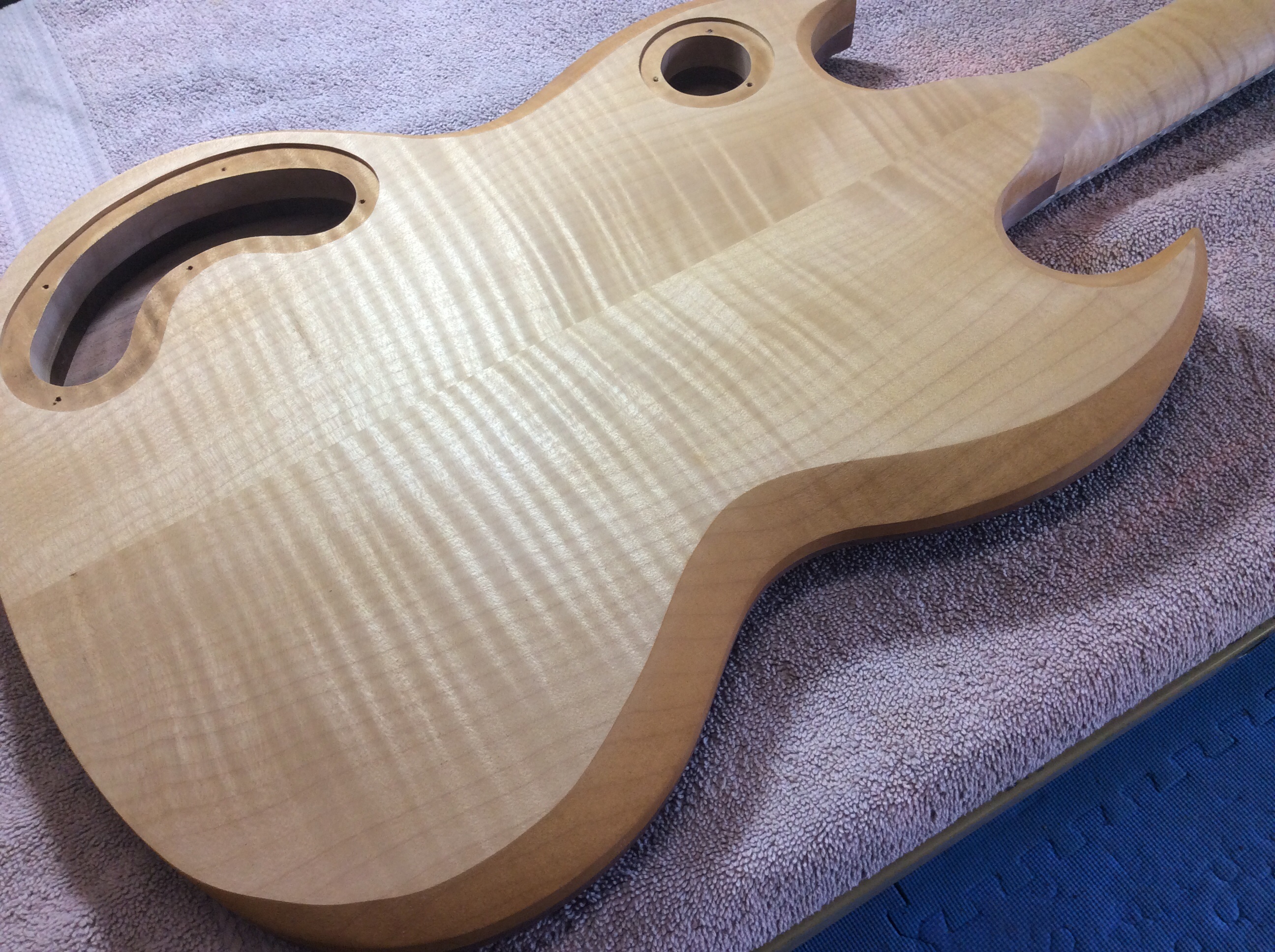

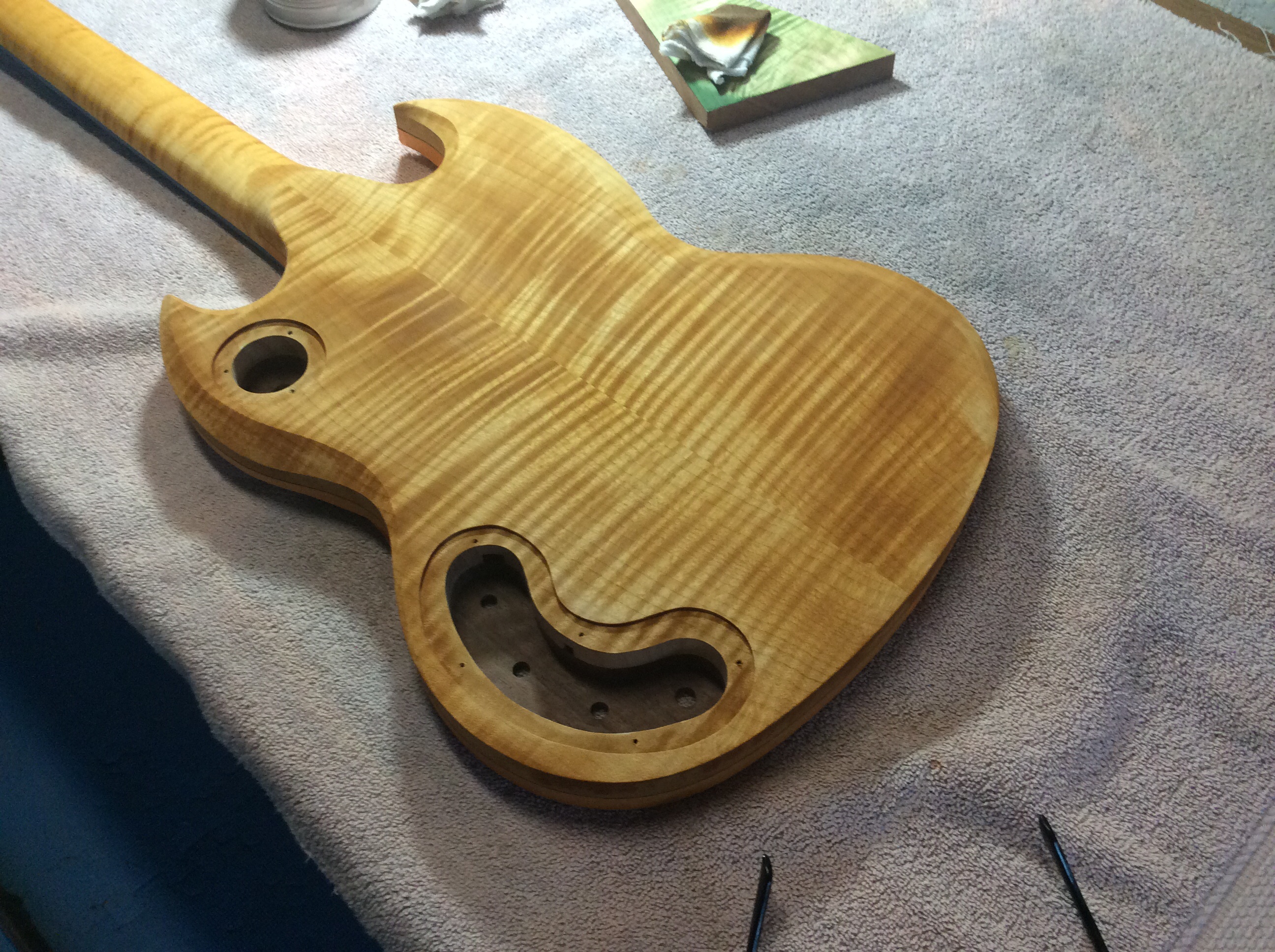

Finally spraying some finish.
Posts: 3249
Nice to see curly maple with a clear finish for once. Too many builders want to ruin maple with dye.

Barry Daniels wrote:Nice to see curly maple with a clear finish for once. Too many builders want to ruin maple with dye.
Thanks Barry!
Actually, I applid an amber dye and sanded most of it off just leaving a tad to emphasize the grain.
Dan
