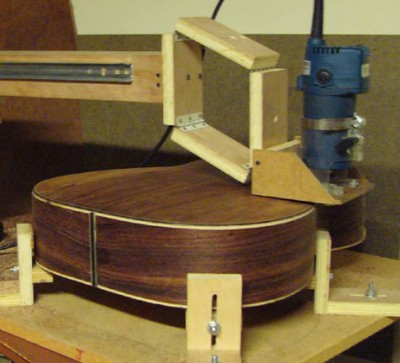

- Posts: 372
Re: Binding Machines - Thoughts?
Here's a photo of the parallelogram linkage of my binding cutter. You can see that the pivots in the parallelogram linkage are short sections of piano hinge.
