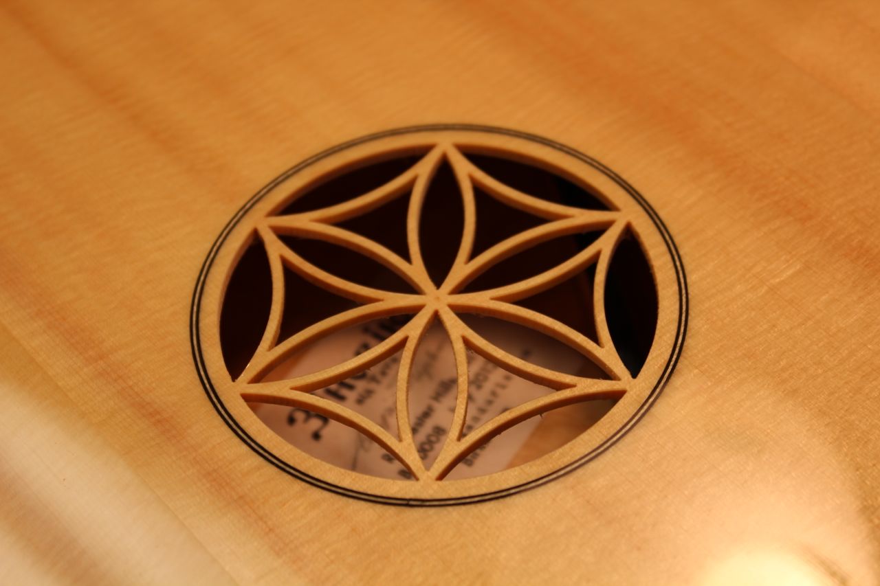

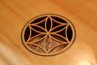

I'm about to try doing exactly what you're recommending Michael, just without the binding afterward for a sound hole in an instrument I'm building right now. The details of the rosette are too delicate to survive a trip to the buffer so my 8 year old suggested that I buff first, then cut (I have a CNC machine) so we'll se how it goes!

I guess it worked. Sanding the fuzz off the back side was tough but possible. Used a downcut bit and the edge of the finish is nice. Sealed the sides with shellac.

How are you going to do any repairs inside that instrument?
Can your 8 year old get his hand inside?

Very nice Andy.

I'm not a repairman. Let him deal with it.Steve Senseney wrote: How are you going to do any repairs inside that instrument?

Sweet! Looks so delicate(and likely is).
If the fuzz was a PITA, for the next ones you could use a downcut bit to cut half way through(or even just to score-through the finish), then switch to an up-cut to complete.

Re: Cutting F holes in existing guitar?
Thanks guys!
To reinforce, I HHG'd very thin calf-skin parchment to the back side. That stuff is super tough and I think even if the wood cracked the parchment would still hold together.
Mario, I had considered doing that but at first I did a bunch of shallow oversized cuts leaving about .005" and then a full depth cut to clean out the cutter marks on the side. I was worried that aggressive cuts would move things around too much (the top is designed to vibrate of course!). I think that perhaps a more aggressive approach would have left less fuzz even with just a downcut bit as I'm suspecting that my feed rates were so slow that the bit was dull by the end of the job (cutting at 30ipm - quite slow)

Oh and to bring it back on topic, I think this proves that f-holes could certainly be added to an existing guitar without damaging the finish. Depending on how drastic the arch is at the location of the f, it could be probably be done using an 1/8" compression bit (upcut on the bottom, downcut on the top) which leaves a great edge on both sides.

Very nice job indeed. Compared to this, cutting F holes would be a walk in the park, (for someone with the right level of skill and experience).Andy Birko wrote:I guess it worked. Sanding the fuzz off the back side was tough but possible. Used a downcut bit and the edge of the finish is nice. Sealed the sides with shellac.
