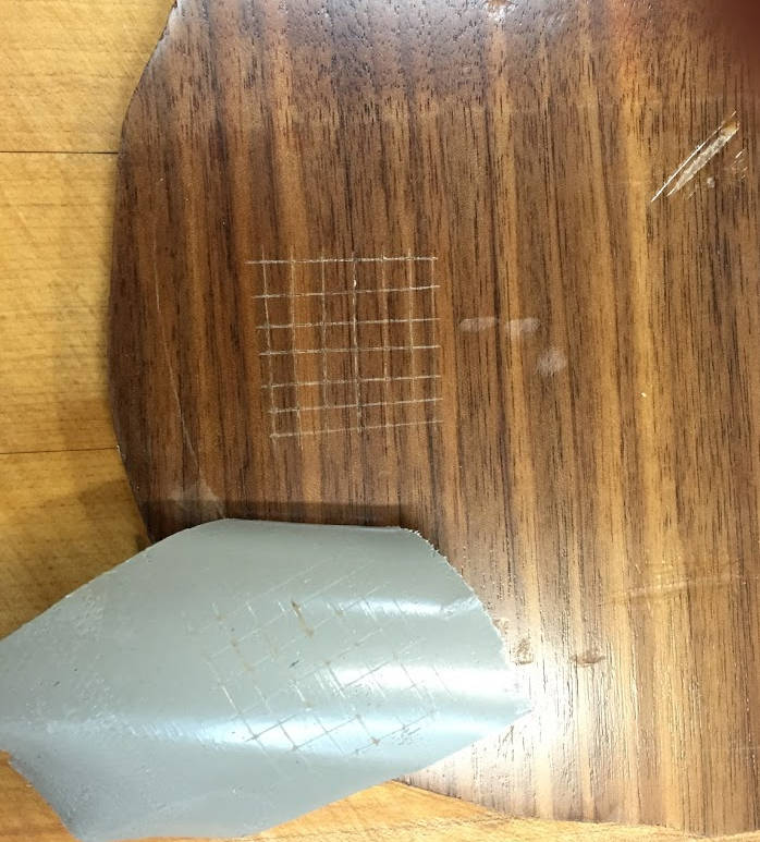

I did the tape test.
Started with clear packing tape - nothing - came off very clean.
Next, 3M masking tape - the wide stuff - nothing
So I put down some Gorilla tape - last night - let it sit all night - ripped it off this morning - see picture.
Oh - by the way, this was on the oil-shellac-EV section of my test board - What I assumed to be worst case

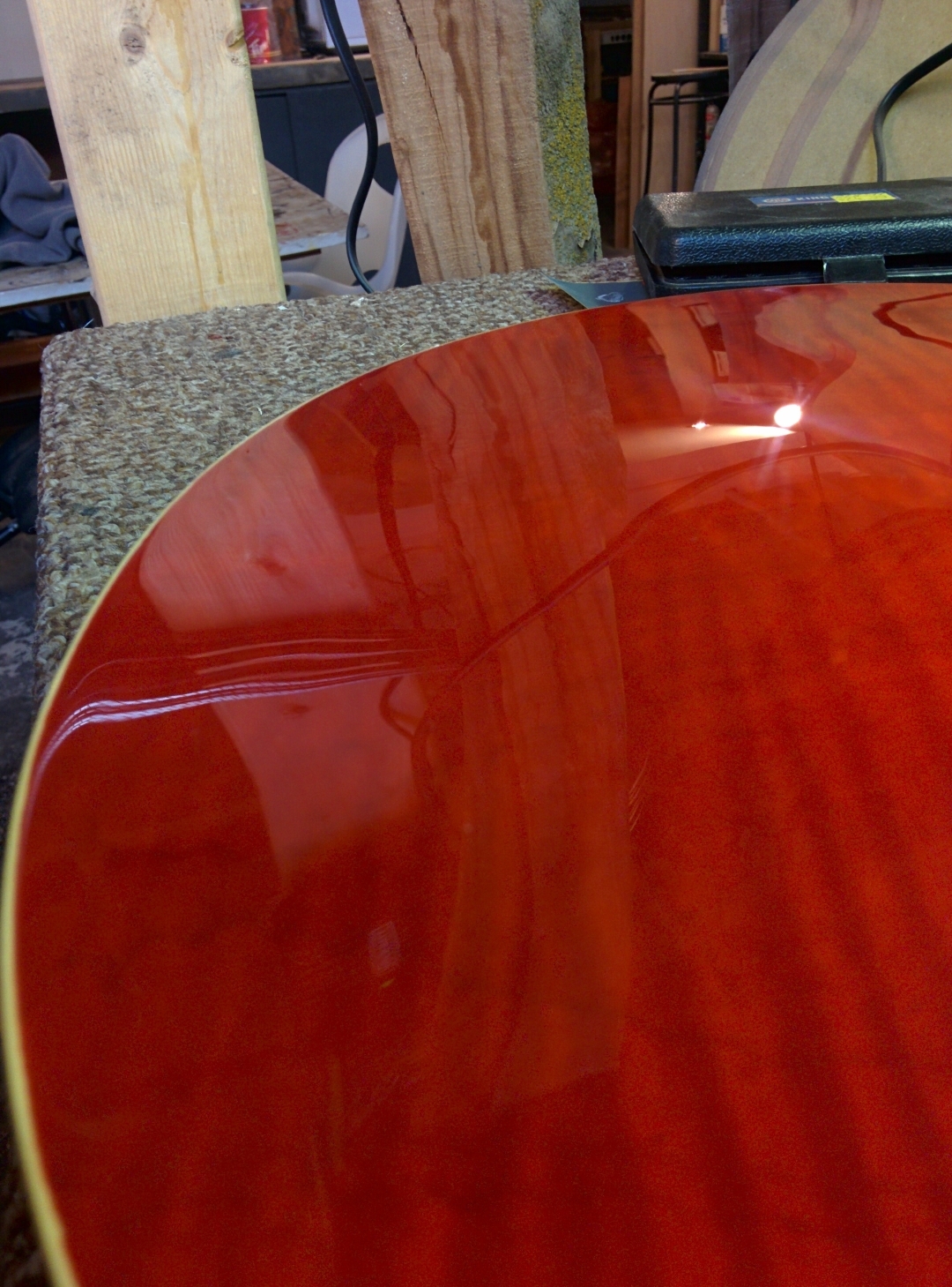

Greg, this was covered in the 7 pages of this thread, but...
If you get all your coats on quickly - within a couple days - you will _not_ get witness lines. I know, because I got witness lines when I waited too long between coats and the burn in was not great. On coats that went on quickly I got NO witness lines at all.
So lesson there - get it all done QUICKLY.
AND
If you get a thick enough film, you will never burn through this stuff. I sanded and buffed my ass of on this stuff, and expected to burn through, but never did. Not even close.
