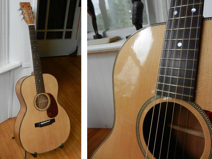

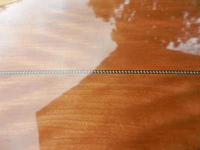

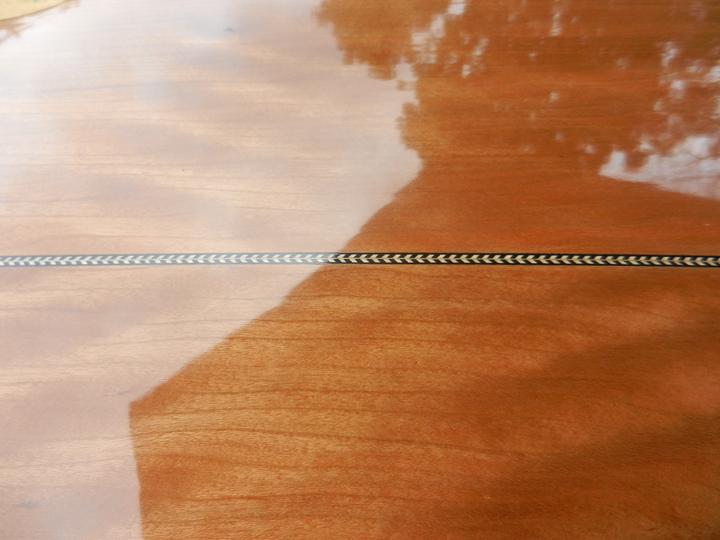

I’m almost finished with my first build(s): two more-or-less identical OOO-12 frets made from some nice quilted cherry I got from a local saw mill and a sitka top. My question is about how to safely level the finish before working my way up through finer grits. As you can see in the photos, the first one has been completed (and, by the way, I'm really happy with the way it sounds - bright and articulate, like some maple guitars I've played). I brushed on about about 6 coats of KTM-9, following directions, and let it cure for over a month. I tried sanding with 400 wet/dry paper on a foam block with soapy water, but in spite of using what I considered a pretty delicate touch, soon began to cut all the way through the finish. I got scared and switched directly to “micro mesh soft touch finishing pads” 1200-8000 grits, then a foam pad on a drill with rubbing compound. The results are not surprising – a glossy finish full of bumps and ridges. It's more noticeable in person that in the photos.
Any suggestions to help me achieve a smoother finish on #2?

+1 to what Barry said. How much level sanding did you do between coats? I do oil finishes with many more coats, but a similiar technique should work with what you're using. Start level sanding (dry with a block) with 600 or 800 after the first or second coat (because the finish is still thin, 400 will burn through too easily). After the third or fourth coat, move back to 400 or 600, getting rid of all the shiny spots is the goal. The better job you do of level sanding between coats really shows up when you start leveling the cured finish.
By the way, that looks pretty good in the photos!
