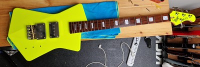

I recently (well a year ago) St.Vincent inspired shortscale bass, and I used a shortscale bass neck off of Amazon (given that you wanted it to be a quick project). Not too terrible, I myself did not do any work on the neck profile and frets (just the headstock), but with a bit of effort, I think they can be made pretty decent. The body has big bevels on top and bottom running out to just over 15mm on the edges, original also has a big belly (or, well) cut which I forgot to add.

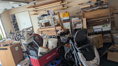

We'll see.....still need to clean the garage.
