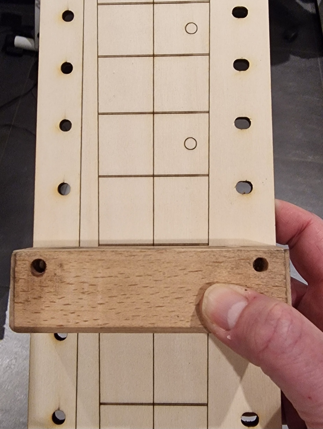

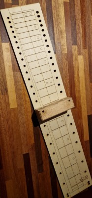

Re: Moving on, a chambered 5-string medium scale fretless
Cut the baseplate with locating holes to cut the fret slots.
The wood for the fingerboard will probably delivered somewhere the end of this week.
Need to change the model for the pickup position, I had the "MusicMan Stingray" position in there, but from pictures it seems that the Gary Willis bass from Ibanez has the pickup a bit closer to the bridge, so I'll change that (and also correct it for the 32" scale, rather than 34 from the Ibanez).
Might rig something up to put string tension on it and see how the neck behaves, before building a complete bass.
Accuracy is pretty good, the saw guide bridge with magnets I made for the little travel bass.The wood for the fingerboard will probably delivered somewhere the end of this week.

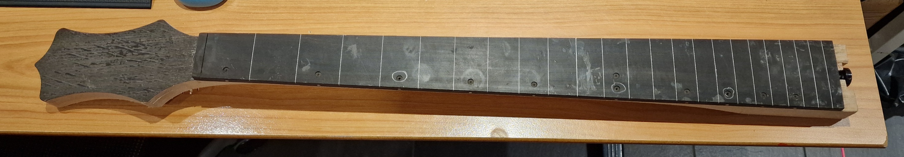

- Posts: 85
Fretboard prepared, sidedots fitted, headstock routed (will need to do some repairs because of a few blown out corners, The bigger follower bit I have is not as sharp anymore, will need to give that a go on the diamond plates.
Glued on the fretboard on the neck, and started neck shaping, a very enjoyable job, who doesn't love a sharp spokeshave?
Will need to be careful, because apart from the trussrod, there are two carbon tubes buried in the neck. The neck does feel considerably more substantial now, so confidence of it holding up is rising (until it drops sharply again, let's hope not

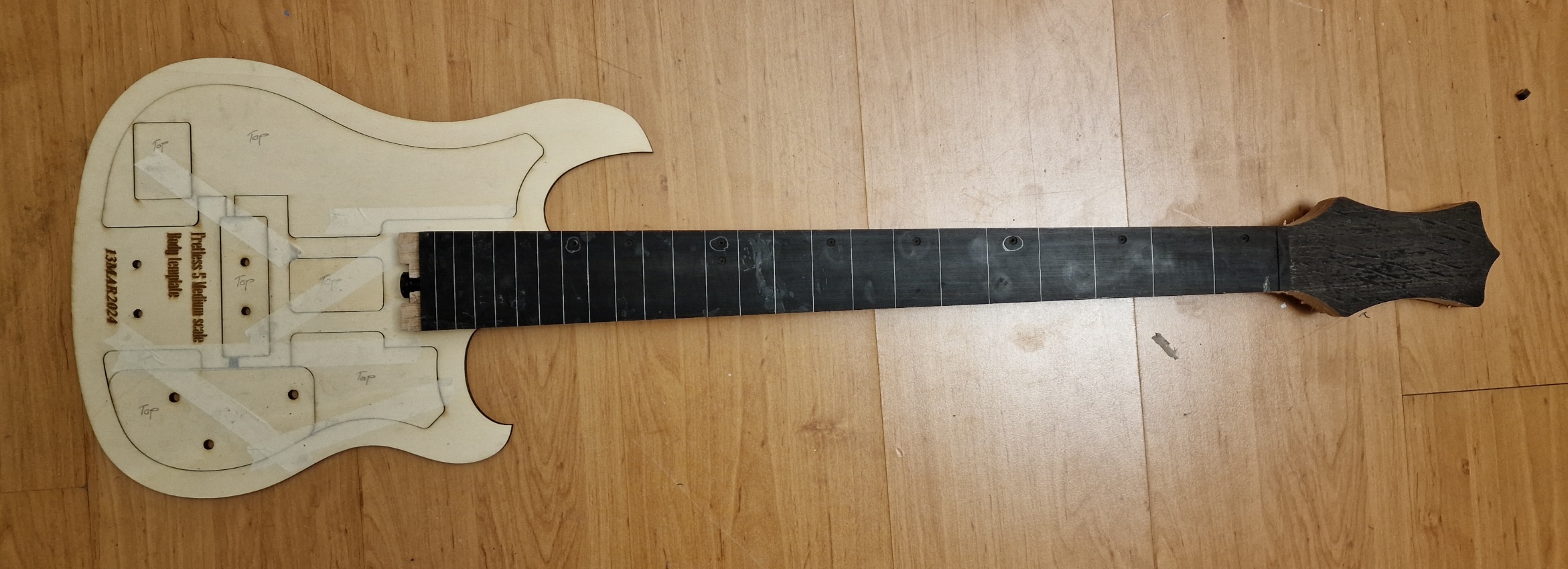

Thanks!
This body shape evolved from my shortscale basses, and is based on the Alembic Stanley Clarke model, but then, better proportioned (IMHO) and with extended upper horn to counter neck dive. This is the first medium scale I am building with it, so let's see how much it likes to dive. And how well the neck holds up, because the "hardwood" I used is really super light, left the fingerboard quite thick to give the neck some rigidity, and added a pair of carbon rods.
