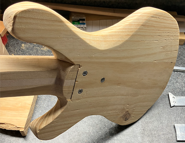

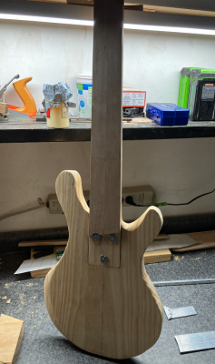

This is supposed to be a testbed for a bunch of ideas I want to try, so I'm using primarily pine. Headless, multi-scale, 8-string, trapezoid/asymmetric neck profile, handmade pickups and tuners. Mostly hand tools.

I like to do things the hard way; I feel like that way I can make a bunch of mistakes really quickly and then learn from them for the next try.
Some lessons learned so far:
  • Don't buy fretwire in short lengths unless those lengths evenly divide by your fretboard width.
  • Pipe clamps or bar clamps are overrated; it's not hard to make a long-reach clamp for body glue up with some scrap wood and wedges.
  • A face vise on a proper workbench is not overrated. It's a toss-up between this or a bandsaw when it comes to "most desperately desired tool".
  • Shape the back of the neck after getting the neck pocket and tenon sorted.
