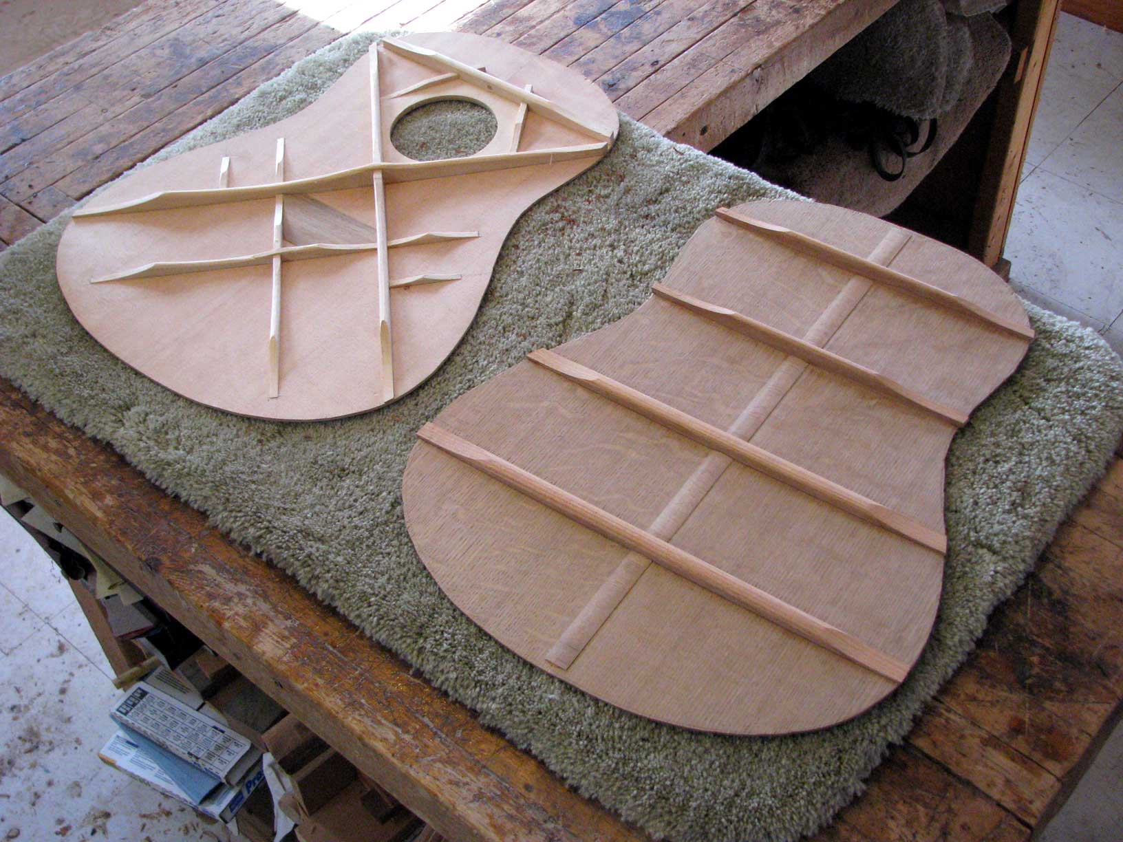

Here's a shot of the rough top and back bracing on one of my guitars. Sometimes it gets trimmed down a lot.
Alan

Thank you, Alan. That will be very helpful.Alan Carruth wrote: ↑Wed May 29, 2024 11:11 am Here's a shot of the rough top and back bracing on one of my guitars. Sometimes it gets trimmed down a lot.
Alan
- Posts: 1390
Re: Left-Handed Acoustic Guitars?
Alan, it is hard to tell for sure from the picture but I assume the tone bars X joint is a half lap just like the main X. It looks like both joints may be capped with a thin spruce cap. Is that right or do you add some cloth later in the process?
Since the double X tone bars are basically tapered braces, do you have a feel for how that compares to standard (asymmetrical) scalloped bracing?
- Posts: 1306
Until I started using the double-X I never had much luck getting scalloped bracing to 'tune' right using the Chladni method. It's simply too asymmetric. It turns out to work much better if you leave the treble side of the main X tall, without scalloping it, as Dana Bourgeois often does. I learned that when I tok a workshop with him on his 'tap' tuning method: Chladni tuning is just a 'tech' method of doing the same thing. At any rate, leaving the treble side of the X tall makes up in some part for the fact that the tone bars run parallel (more or less) and perpendicular to the treble leg of the X. If you try bending the top along the two diagonals you'll find that with fully scalloped bars it's much more flexible one way than the other, and that messes up the symmetry of the modes.
