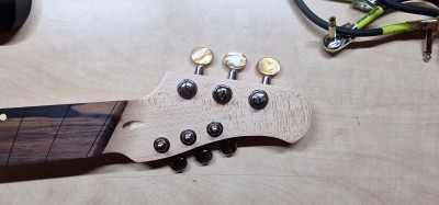

Was keen on assembling it, so I made the recess for the nut, and fitted everything else. As imagined, finding out the right strings and tuning is a bit of a puzzle. Right now it has a 5-string set made for the Ibanez Mikro 5, but tuned E-A-D-G-C (as are all of my other regular 5-strings). But the two lowest strings require a lot of string on the capstan of the tuning machine, not ideal. Also, the strings are obviously thick and stiff, so that is noticable. The plan was to tune this an octave higher, as is the Mayones Cali and Mub Miezo, might still end up doing that.

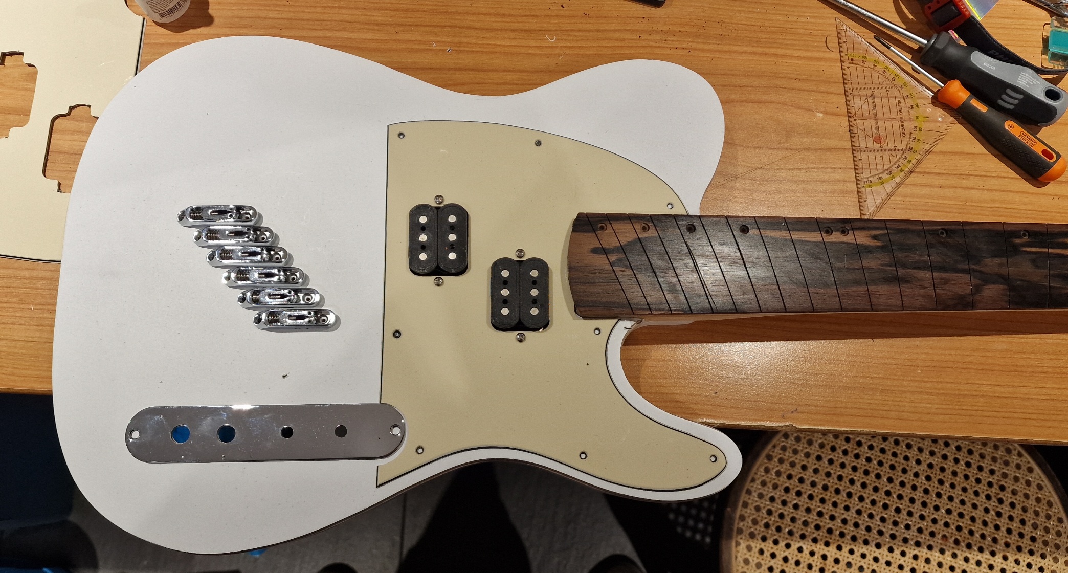

Biggest and the smallest (in our house anyway)
Jarno Verhoeven
Posts: 87
Re: Hello again! And next little project, a travel bass of sorts
Post by Jarno Verhoeven »
The rear:

Can you cut the strings shorter so they don’t bunch up on the tuner post?
Jarno Verhoeven
Posts: 87
For three out of five, yes, certainly, but the lowest two strings are to thick to fit on the tuners (those have a taper on the end to fit in the tuner). The original plan was always to tune it an octave up from a regular bass. Might do that, because the thick and stiff strings also don't play as comfortable as I'd like.

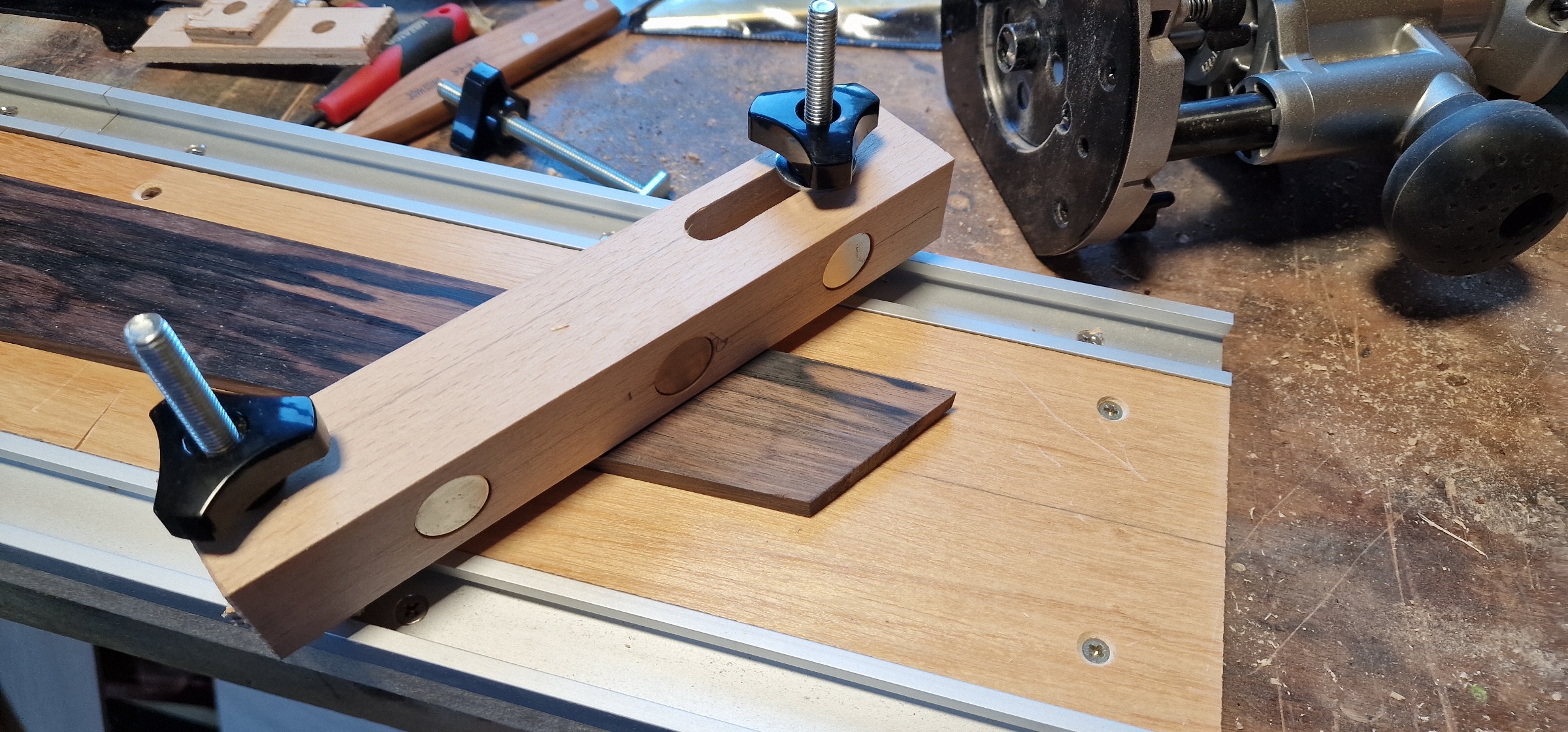

But I will say that in the meantime, I've made something else because I am working on a multiscale instrument:
You can get a set of rails and T-nuts etc. on Amazon for I think 30 euros or so, and so I used that, a piece of MDF as a base and a few pieces of beech for the guides, fitted with 20mm neodymium magnets.
Works really well.
The right angle guide still has too much slop to use it without checking for square though, figured that by making a reference edge it would always be square, but that is not the case. Both of the guides are bombproof, no wiggle at all.
