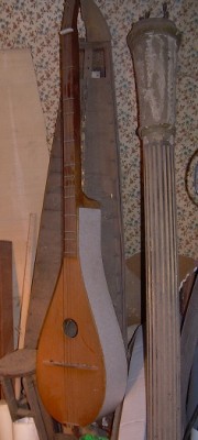

Re: Stew Mac already body built kit? Thinking of ideas for neighbors' kids
Stick dulcimers might be another possibility. I build them with Formica back and sides, "A" grade spruce that doesn't pass the runout test or western red cedar from the lumber yard, walnut (or other hardwood) necks with the frets pressed into the neck (no separate fingerboard) and cheap tuners. Cost of materials, including strings - about $17
* - Because the bridge is a "floating bridge" (not glued on) runout is less critical so more can be tolerated.
