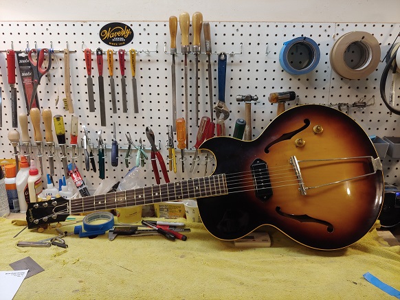

Sorry for the poor quality pic, my file reducing app maybe isn't the best. Anyways, just wanted you know a built the guitar. Thin body, hollow, maple back, sides, soundboard, and neck. Ebony fretboard & headstock veneer, P90 pickup, bolt-on neck, rear access to pots/wiring. Thanks everyone.

Re: slim hollow body with P90
Hey Barry and Freemen,
I was just gonna silently lurk, but just wanted to say....awesome work!
