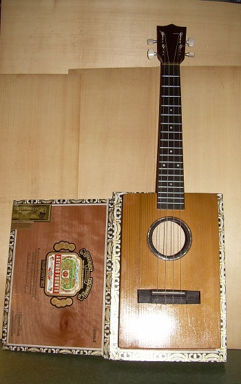

Similar to what Peter has suggested, you might try a less ambitious project with him first. Something like a Tenor Uke with a few premade parts might be knocked together in a few sessions and let you gauge his level of interest and how involved he wants to be. You can find necks, fingerboards, bridges and tuners on eBay for a few bucks. You can teach him to bend wood and make a typical uke body, a pineapple shape, or find a couple of cigar boxes depending on his skill and how quickly you want a "first project" to be done. He can learn the basics of woodworking and finishing as well as about scale length, compensation, and the ergonomic considerations of building an instrument, without getting bogged down in a lengthy project. If he successfully completes the uke he may have a better understanding of the commitment it will take to build a guitar, and have a fun little instrument to play.
https://www.ebay.com/itm/Tenor-21-23-26 ... SwQPtfmjYw
https://www.ebay.com/itm/Ivory-Nut-Rose ... SwTS1fNf2e
https://www.ebay.com/itm/4x-Tuning-Pegs ... SwvKBe8G2w
Many years ago did a dulcimer building workshop with my sons' boy scout troop. It took a couple of months of weekly sessions for the dulcimers to be built and finished. Some of the scouts really enjoyed doing it and built same nice instruments and some didn't. All the Scouts wanted to do it initially but some lost interest over time. I think a less drawn out project would have held their interest better and given a better success rate. Although I enjoyed the experience of teaching, I don't believe I was particularly good at it.

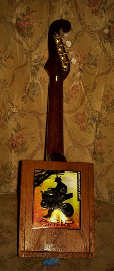

A few examples of quick to make cigar box ukes:
