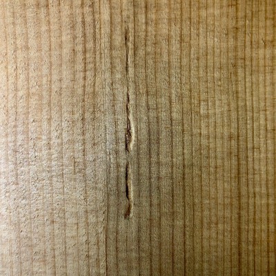

Hello,
Some glue dripped on the spruce top I'm working on and dried before I noticed. I tried to get it off without damaging the top but I failed. This is the result.
How would you approach this? The box is already closed and I'd rather not start over. I can see some possibilities but I am going to pause and get some input from you experienced guys. I already tried to steam it and this is all I got. It only improved it a little.
Also, how would you remove the glue spatter in the first place? I've never worked with woods this soft before starting to try to make guitars.
Thanks,
Posts: 3249
Re: Can This Be Fixed?
Depending on the type of glue, you can remove dried glue easily with either a damp cloth or a card scraper.
Fixing that area will not be easy or result in an invisible repair. You can either fill it with something or cut out the area and patch it.
If you have some cut-offs of this top, use them to test different fillers. Glue and sawdust is recommended by a lot of folks but usually turns out much darker. I would try Durhams Rockhard Water Putty, which dries to about the color of spruce or a little lighter. If it turns out to be too light you can darken it with a bit of colored powder when you are mixing it up. A fill into spruce will always be visible, but it least you can make it level and smooth.

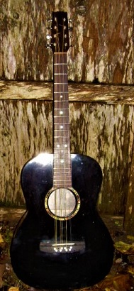

Perhaps a good opportunity to try your hand at a sunburst finish (if it's out near the perimeter)?
JC Whitney wrote: Thu Jul 13, 2023 4:20 pm Perhaps a good opportunity to try your hand at a sunburst finish (if it's out near the perimeter)?
+1 on the sunburst idea!. If it is not near the perimeter you could do a "black face" or painted top.
