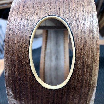

I got the side port for the second guitar I'm making in this run. I'm using curly maple for the binding of the guitar and the port. This one turned out well.

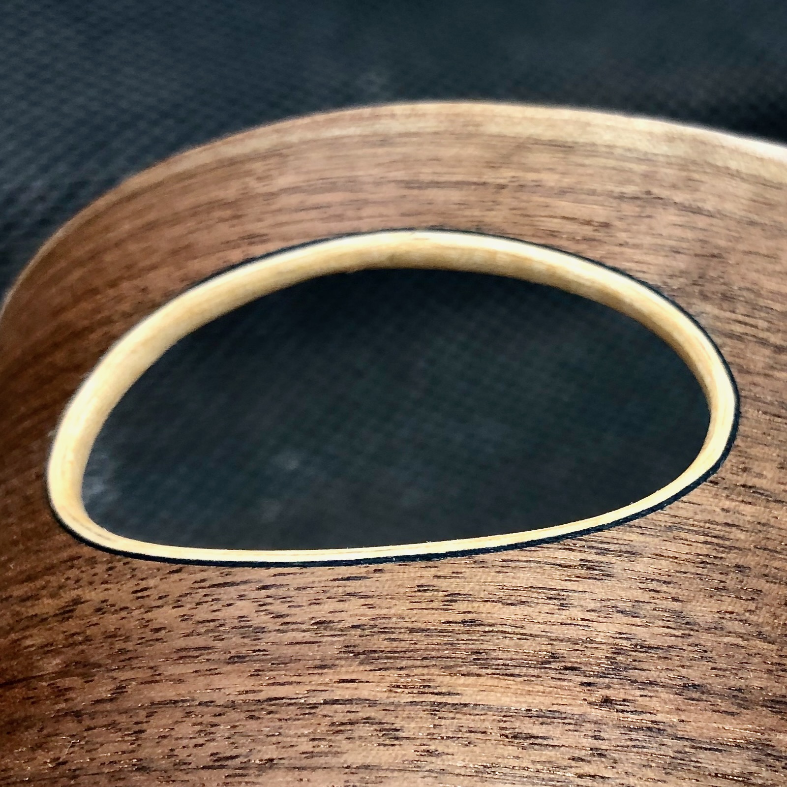

This shows the scarf joint. I'll take it!
If I like the sound of a side port I will be hooked, I think. I'm back on track after over a month of trying to figure out binding side ports.

How do you do the binding inside the porthole with that double curvature? I can't get it done without it splitting. I tried using a wide strip over sized then cutting back to the contours of the side but cannot get it into the oval soundhole without splitting. Are they laminated? If so how. Please do share!
Eric Knapp
Posts: 650
Location: Wisconsin, USA
Re: Another Side Port Done
Post by Eric Knapp »
Bob Orr wrote: Sat Jul 22, 2023 6:14 pm How do you do the binding inside the porthole with that double curvature? I can't get it done without it splitting. I tried using a wide strip over sized then cutting back to the contours of the side but cannot get it into the oval soundhole without splitting. Are they laminated? If so how. Please do share!
Hi, Bob. I documented my process in this thread. Let me know if you have more questions.
https://www.mimf.com/phpbb/viewtopic.php?t=6826
Bob Orr
Posts: 147
Post by Bob Orr »
[Hi, Bob. I documented my process in this thread. Let me know if you have more questions.
[/quote]
Thanks Eric that is great. The tapered plug idea is terrific as is cutting multiple veneers incorporating the purfling and I will be giving this a go on my next project. Now, where did I put that offcut of birch plywood I kept "just in case"
