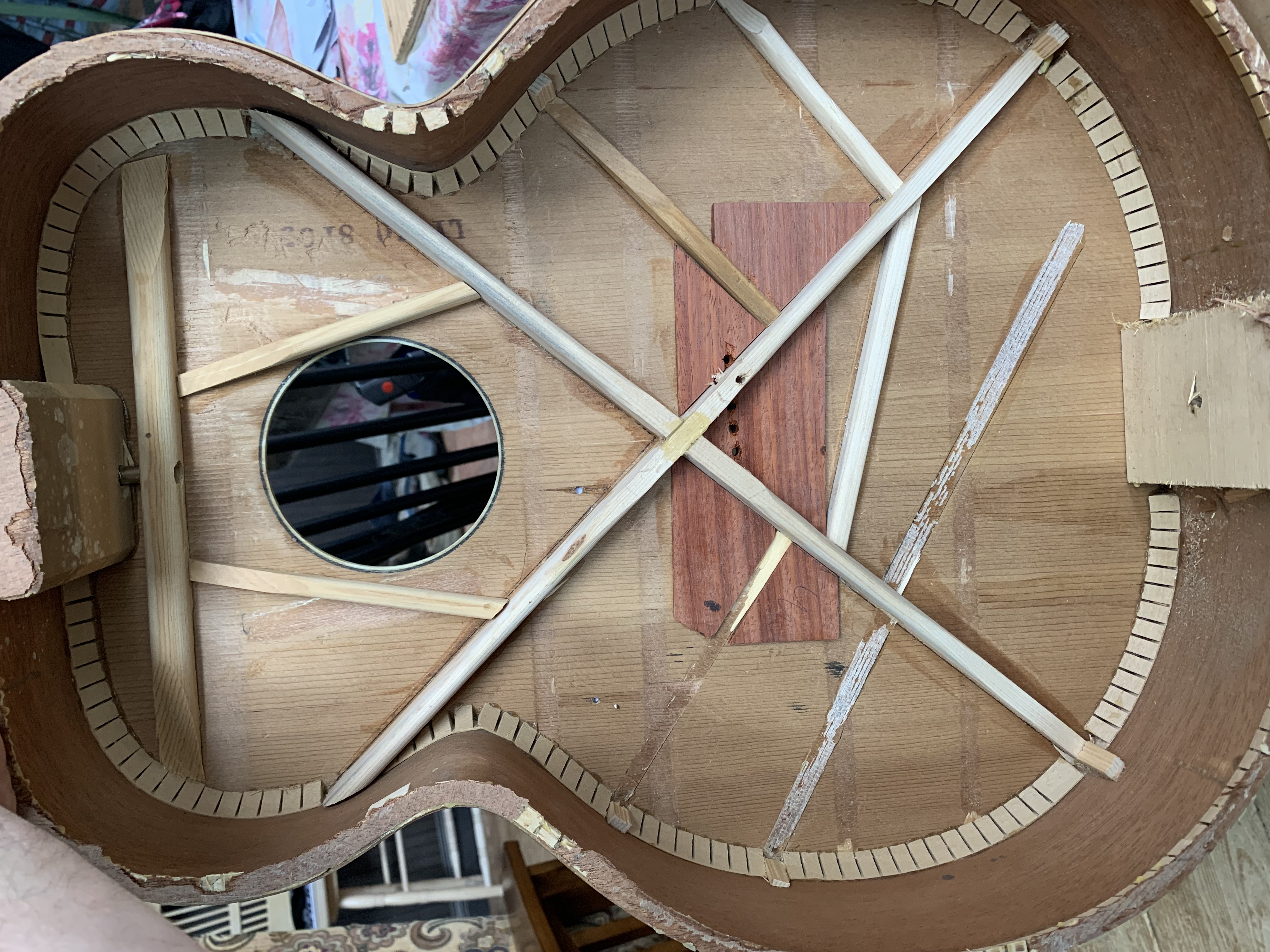

Finished. Glued the original ply back yesterday. Bunch of mistakes were made. Top is way too stiff. I can’t even flex it by pushing down on it. I used a 1/16” piece of Pauduk for the bridge plate. There’s a string peg hole that goes through a main brace. Braces are too thick and tall, too bulky. There’s no bass at all. When I strung it up and hit the low e string I knew something was wrong. I’m going to attempt to use a thumb plane through the sound hole to remove mass from the bracing. I feel awful, it’s a really cool old guitar…

Anybody have any suggestions? I’m open to anything that will help this old beauty!

It is over-braced. Thinning the braces through the sound hole is not easy. Could you pull the back to work on the bracing? We can give you some brace dimensions to shoot for if you can figure out the best method to access them.

I used quarter sawn spruce. I could pull the back again and put on the solid one I was going to use. Ok, so it’s over braced, I wasn’t sure if it was that or the Pauduk bridge plate.

How big was the bridge plate? The 1/16" thickness is actually on the thin side.

The bridge plate is about 2 1/2”x7”. And it’s in pieces, as the main x braces run through the area. Can’t really see much in the picture because of my excellent gluing technique

I think that besides the x brace being too thick and probably too high, the center of the x is placed too far toward the tail, toward the most resonant part of the top, and the vertical angle of the x needs to be widened, again to avoid the most resonant area.

I think you would have better results if you used smaller and properly positioned bracing. Having a string pin hole go through one of the X-braces is also a near fatal flaw. If you take it a bit slower and take our suggestions, I think it should turn out better.

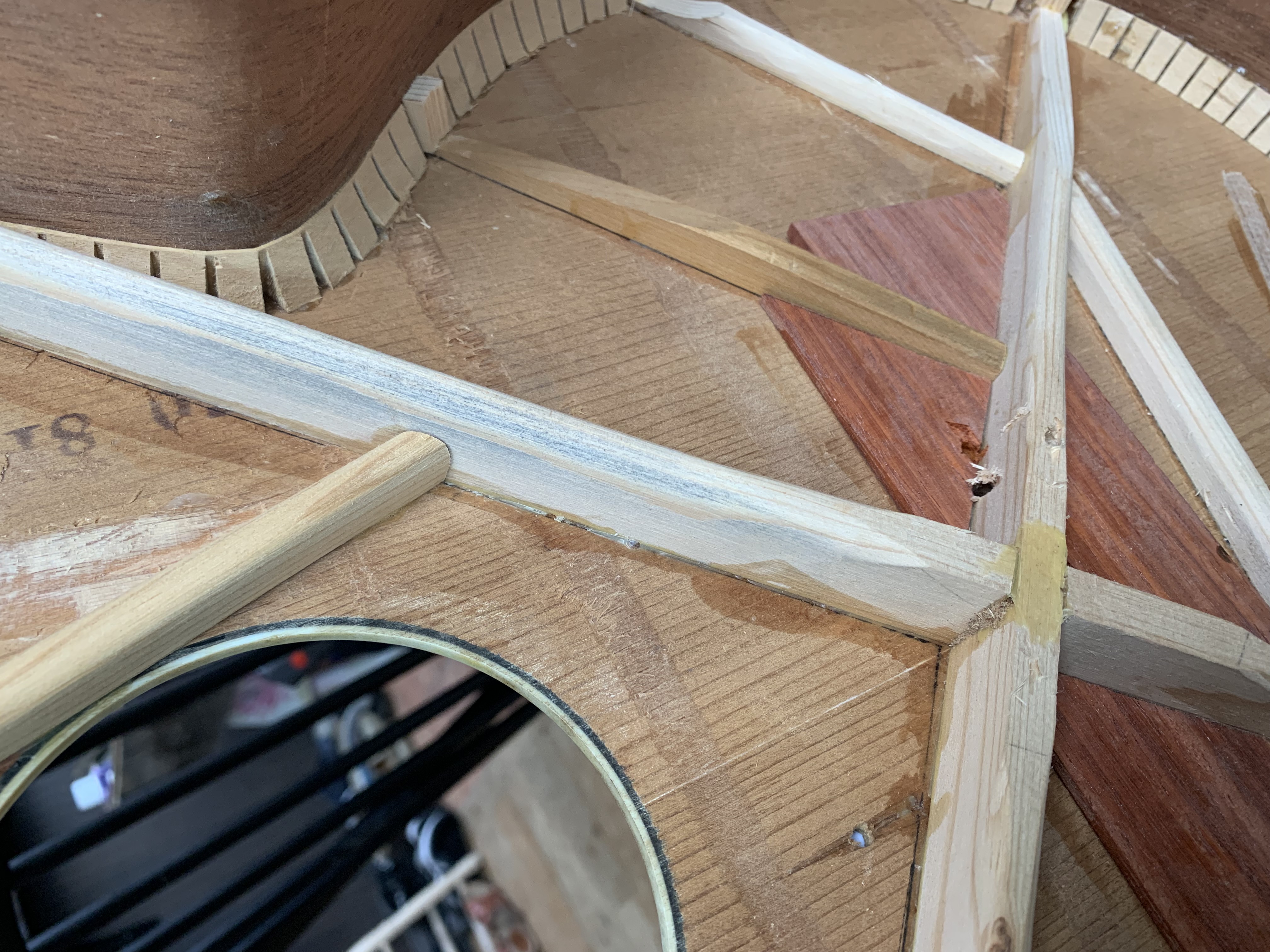

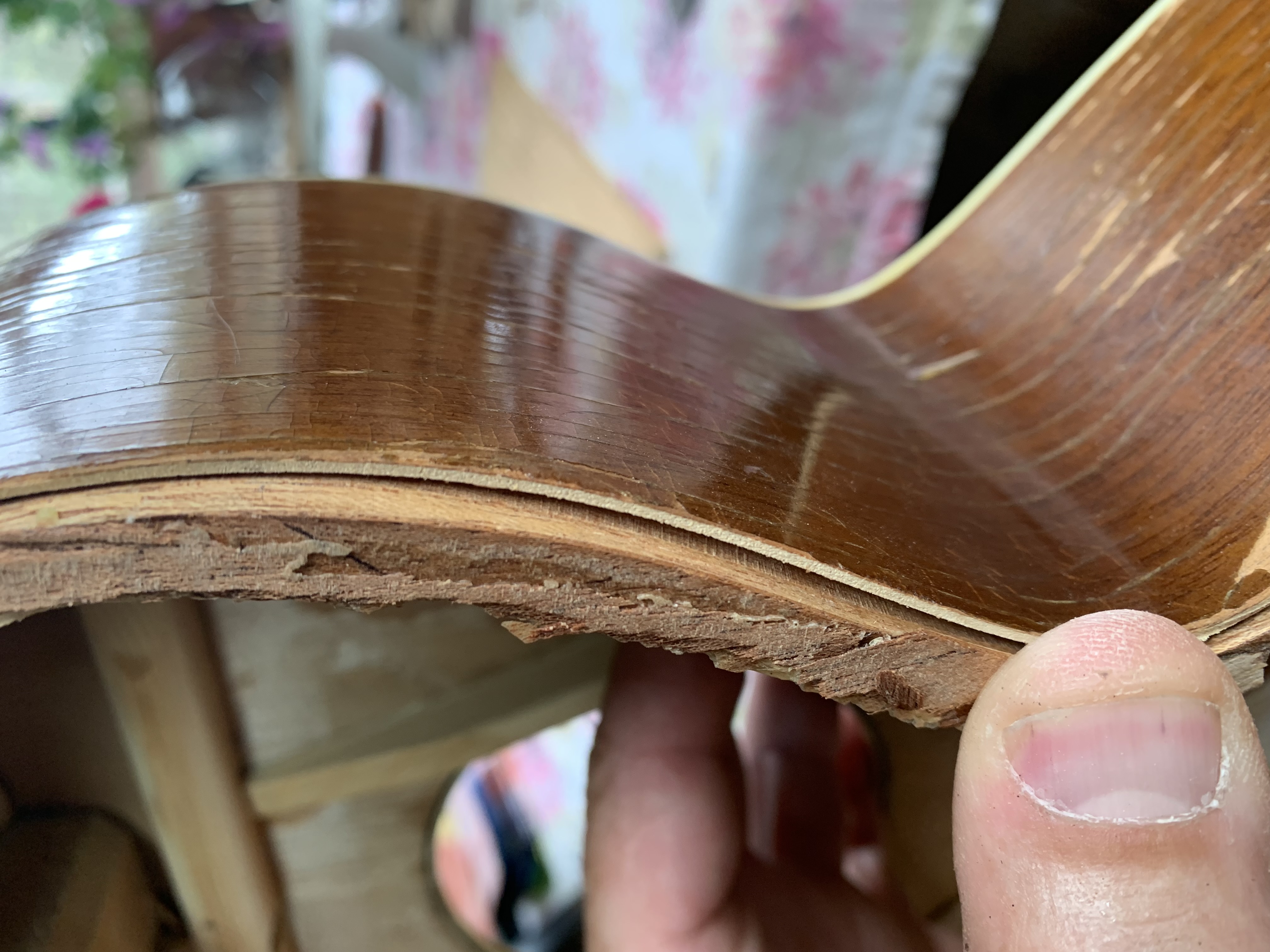

Here’s how it’s going so far. This is a picture of the bracing that I had put in and some more so you can see how big they are. The side laminate has delaminated a bit in an area. I have to glue that back together before I do anything else I think.

I see a lot of issues here. Where to start? The X-brace is poorly located. The bridge pin holes should all fall between the braces meaning the X-brace intersection needs to be a lot closer to the sound hole. The bridge plate should only be located in the lower quadrant of the X-braces. All bracing in the lower bout of the guitar should be much lighter. The ends of the braces should taper down to nothing instead of hitting the guitar sides at full height. The brace between the two lower legs of the X-brace should not touch both braces.
I would shave down all the braces and start over. I think you can get a lot of tonal improvements if you follow our suggestions.
