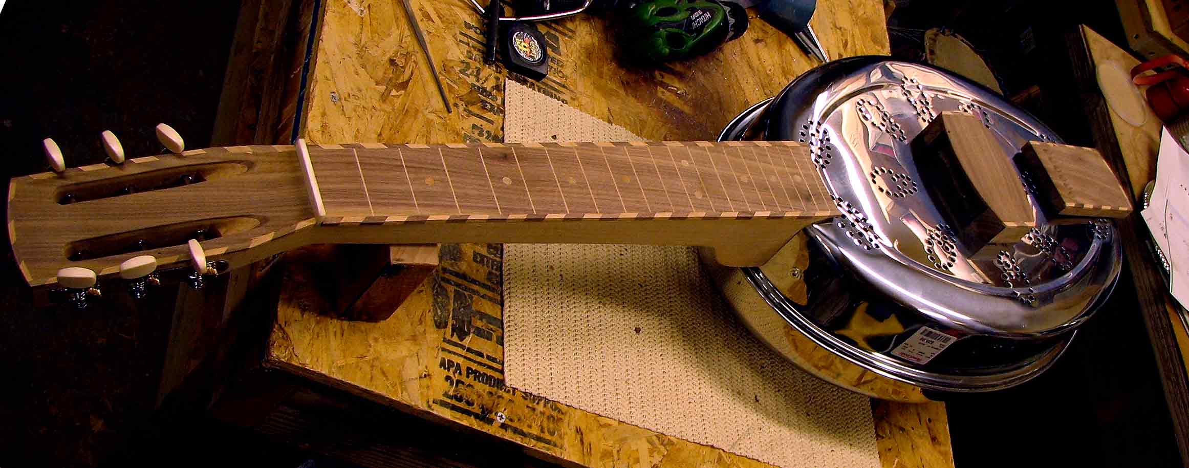

I did a rope binding years ago on neck, bridge cover and tailpiece of a reso guitar I made. I made strips of walnut and alder, cut them into small pieces with a simple home made miter box, and glued them piece by piece into the binding channel. It was easy but tedious, and worth the effort.

I used Elmer's yellow carpenter's glue, which is what I use for almost all wood joints - just make sure you clean it up well and sand, as it won't take color with stain or lacquer. If you're using wood, I'd imagine any wood glue would work, like Titebond or even fish glue. For plastic bindings I've always used acetone, though it may be a little messy if you're gluing in pieces.
