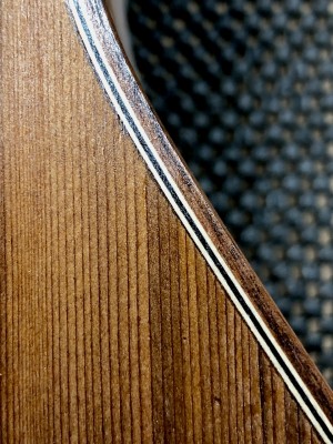

I made good progress on bending the binding for my first guitar. It's glued on and there are very few noticeable gaps when looking at it from the top. There are some small gaps on the side that I'm filling and that's going to be ok. Not as good as from the top but it is progress. For my first time doing binding and purfling I'm going to call this a success. I cut the channels by hand using some homemade gramils.

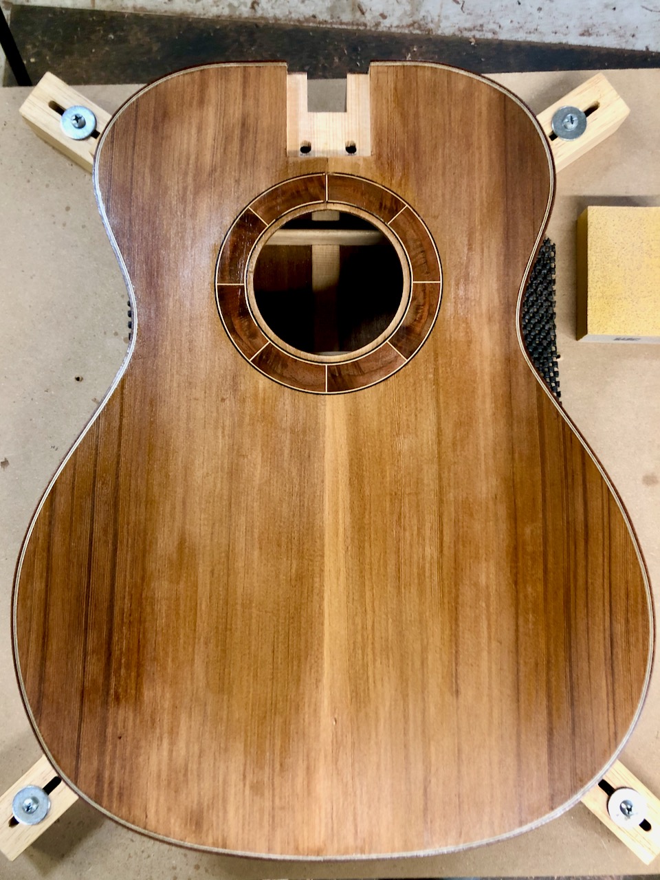

I scraped and sanded the top and added a quick coat of 1# shellac. The top is Western Red Cedar from a leftover piece of siding.
Some closeups of some good sections.
The binding is rosewood and the purfling is maple veneer and a black-dyed veneer.

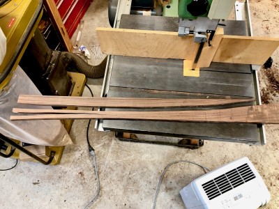

I was able to finally bend the binding by starting over. Here's the rosewood board that I cut along the grain line. I'm an long-time woodworker and was fixated on everything being straight. It dawned on me that since I would be bending the binding strips they didn't need to be straight to begin with. The board is perfectly quarter-sawn and by follow the grain lines the strips have virtually no runout. They ended up being very flexible and bent easily. The other thing I did, based on everyone's advise, was to lower the heat of my bending iron. It was hot enough to easily scorch the wood so it must have been way too hot.
Here's one last shot of my first rosette. I had no idea what I was doing so I just improvised. After adding the shellac it glowed nicely and I thought I'd take a gratuitous shot.

Great job, it looks really nice. Kudos on cutting the channels by hand. That is no small task, especially on a first guitar.
You will see any gaps way more readily than anyone else will. I find it is much harder to eliminate gaps on the back than on the top. Since the body tapers on the back you have to get the binding to bend in both directions at once. If you do the style of taper that is mostly north of the waist it can be even more challenging. The more guitars you make, the better handle you will get on getting them clamped in tight.

I like the larger segments in the rosette. It’s reminiscent of wide stained glass.

Really nice work, Eric. Cool that you went for "character" using the repurposed WRC rather than regular old spruce, and the rosette looks complimentary to the front plate.

Thanks, Karl. I have a lot of walnut crotch figure pieces and I was happy to find one with some curves.Karl Wicklund wrote: ↑Wed Oct 13, 2021 6:20 pm I like the larger segments in the rosette. It’s reminiscent of wide stained glass.

Thanks, Mike. I think I am more interested in using reclaimed and found wood for my future guitars. I have enough of the WRC for another guitar and maybe a ukulele. I also have some old redwood siding that is quarter-sawn and came off a neighbor's house. I have enough of that for 5 tops. Then I have a bunch of spruce, too. I'm set for tops for as long as I have eyes and hands. I intend to keep building and I hope I can.Mike Conner wrote: ↑Wed Oct 13, 2021 6:26 pm Really nice work, Eric. Cool that you went for "character" using the repurposed WRC rather than regular old spruce, and the rosette looks complimentary to the front plate.
