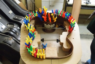

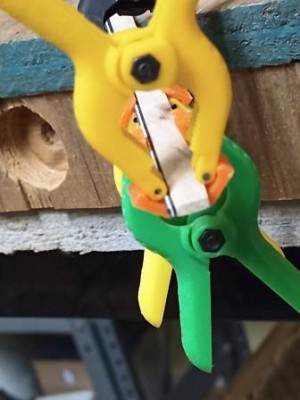

I've been using the small plastic clamps from HF for this. They make that process very colorful I also use them for clamping the purfling to binding before bending. They come in two sizes. I mostly use the small ones but the bigger ones are useful when you need a little more pressure. They're cheap too. But when they occasionally break, I save the parts to fix them.
He's some pics.
