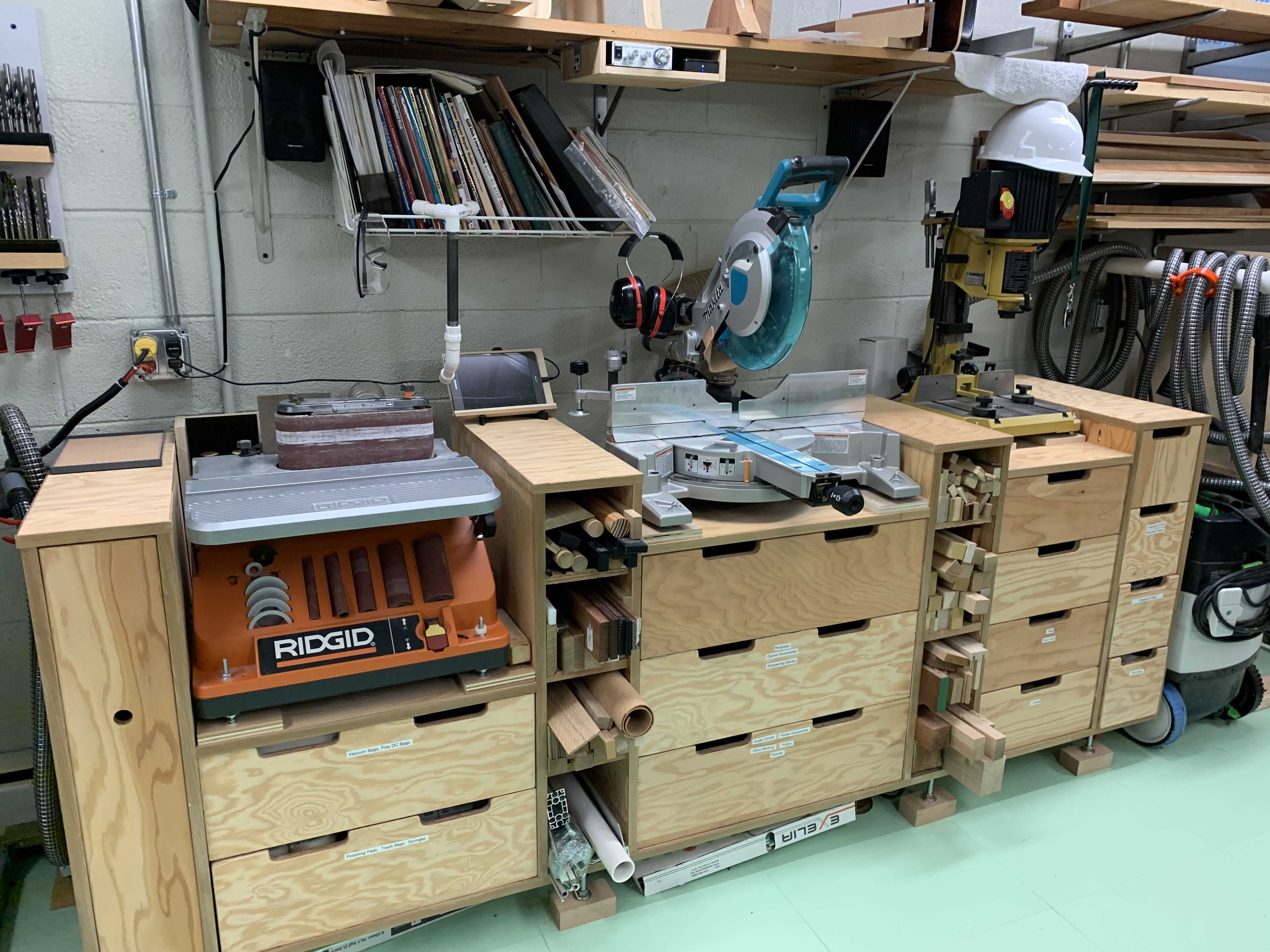

Peter - everyone suffers from that "offcut" problem. And yes, you don't want to just throw them all away, it's a great resource! I learned from a fellow woodworker in my area to have purpose-built offcut storage, then be rigorous about never keeping more than you can fit into that storage! If it starts to overflow, it's time to spend a few minutes "culling the herd". I built what I call a "tool station" that incorporates offcut storage. It's 24" deep, so nothing much longer than that is kept here. I have a small rack you can see high on the wall to the right that handles a few longer pieces. I've found this works really, really well, and I almost never find myself short of a piece, even a specific species. I have also escaped the syndrome of having offcuts piled everywhere and leaning against the wall, under workbenches, etc.
For those curious, there is a PVC "duct" that runs behind this which feeds into a shop-vac that permanently lives at the right end of this bench, hence the blast-gates. The vac is one that automatically goes on when the power supply is engaged, so everything here is routed to the outlet on that vac. All I have to do is remember to open the blast-gate for each tool, and make sure the other blast-gates are closed. :roll:

Steve that looks like a well organized solution to the off cut problem.
