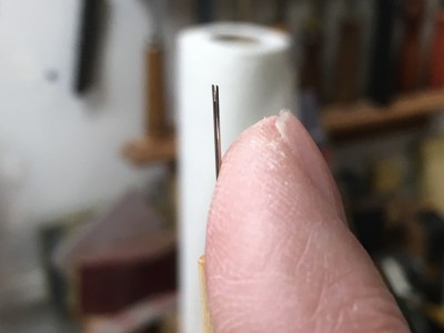

I use a toothpick to do drop fills of lacquer or CA on finish dings. But really tiny pores don't need that much liquid to fill them. The toothpick results in a large mound that has to be scraped down. Needles don't work very well because surface tension holds the drop above the tip of the needle. I saw a tool online for this so I had to make my own version. I took a sewing needle with a really small eye and ground half of the eye away resulting in a tiny fork. It allowed me to place a minuscule amount of CA in the open pore on a rosette, that required minimal leveling. I have read that you can clean the build up of glue residue on the tool by burning it off.

I like that. It solves one of my problems. I’m gonna make one, too.

Good tip! I have been using micro pipettes for CA but sometimes even that is too much.

Slick! We will all be raiding the Frau's sewing supplies

I've encountered this problem many times and have made many different tools to apply CA.
A plastic drinking straw cut at a long angle to a sharp tip and the tip split to different lengths. A pair of short lengths of guitar strings inserted into a dowel handle. Tooth picks cut like a quill pen. Whippet tips heated and stretched. Wound guitar strings both standard and nylon core.
I like your idea because I can go to a sewing center and purchase a fair quantity of fine needles all the same and expect consistency in operation.
There may be a method or step someone will discover to encourage the CA to move more readily into the eye of the needle such as wipe the needle with an acetone q-tip or something like that. The problem is that CA has a habit of misbehaving and not going where you want it to go.
I use the plastic caps from discarded water bottles to hold a puddle of CA when doing things like this.

There is a note in the old Glue FAQ thread that mentions using a cleanly cut, wound guitar string for drop filling. The tip wicks up a small amount for small repairs.
