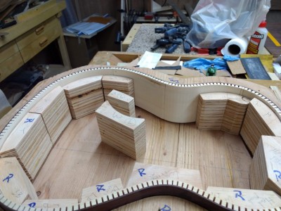

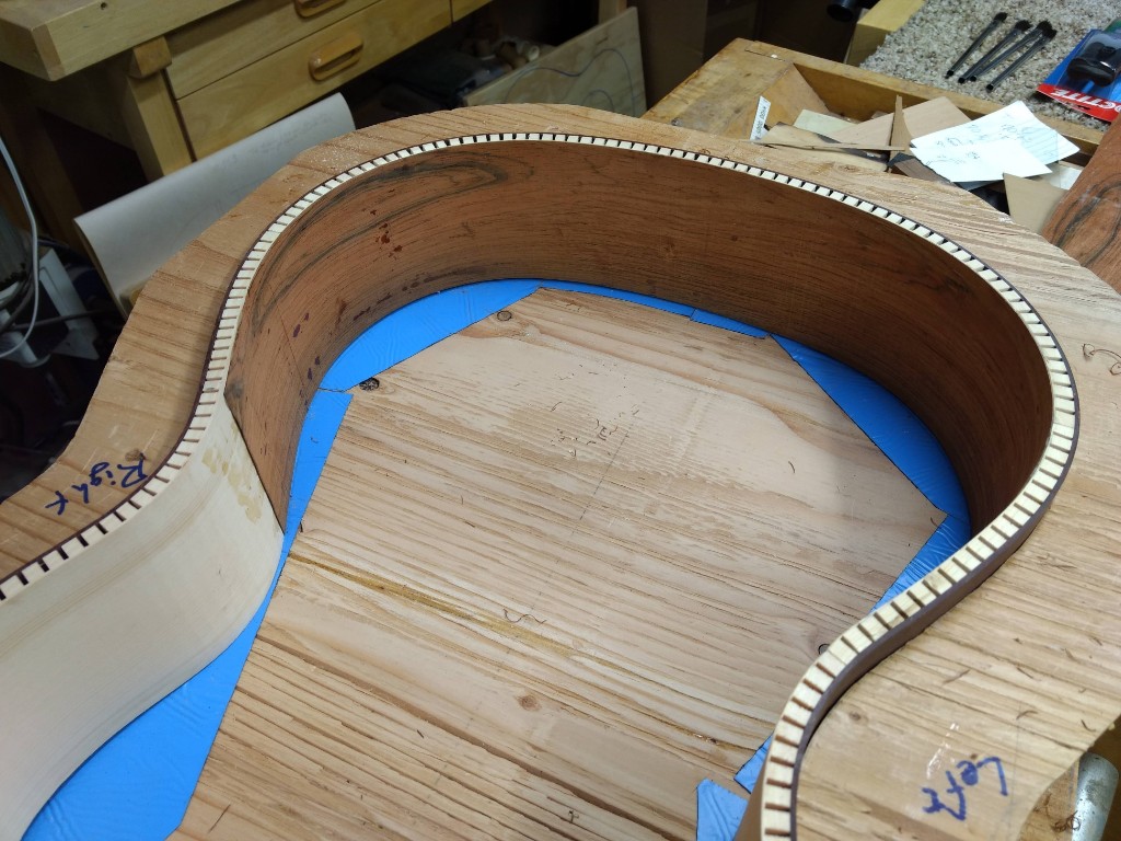

I'm going back to a previous discussion rather than starting a new one, not sure which is proper protocol. I've done double sides in the past layering up veneers, but I never felt like that was doing what it was supposed to, which is giving a more solid foundation for holding the soundboard and reducing energy loss. Envisioning a piano frame and case. So I decided to go a bit further using a full width reverse kerfing.
Cheers !
I re-sawed a clear pine board in half I and kerfed it on the table saw. I thinned the solid side with the drum sander to get it flexible enough, layered up some plywood and cut out the cauls. Finally I glued the kerfing to some sides in sections as it was too ungainly to try to do it as full lengths. I used a lot of titebond and the result is as shown. Last night I epoxied in some rosewood veneer and will finish that up today. The final thickness of the sides is 10mm or a bit over 3/8". These sides hold shape like nothing I've seen before. It sounds like lumber when tapped on.
I like not having an end block and I'm thinking of ways to smooth out a heel block.Cheers !

Re: Double sides
In the case of the fully kerfed sides I show above, yes. I'd say none actually since it was glued together in the form and it still fits closely into the form even with top and back attached.Matt Atkinson wrote:I imagine laminated sides have very little springback?
