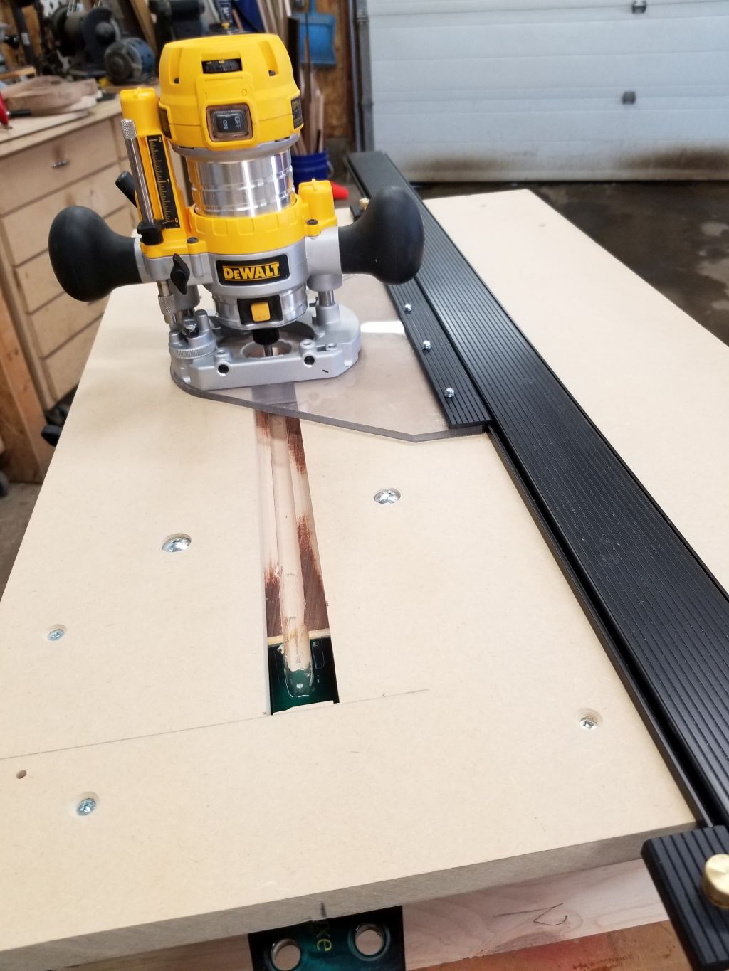

I made up this jig that utilizes my Veritas tool guide.

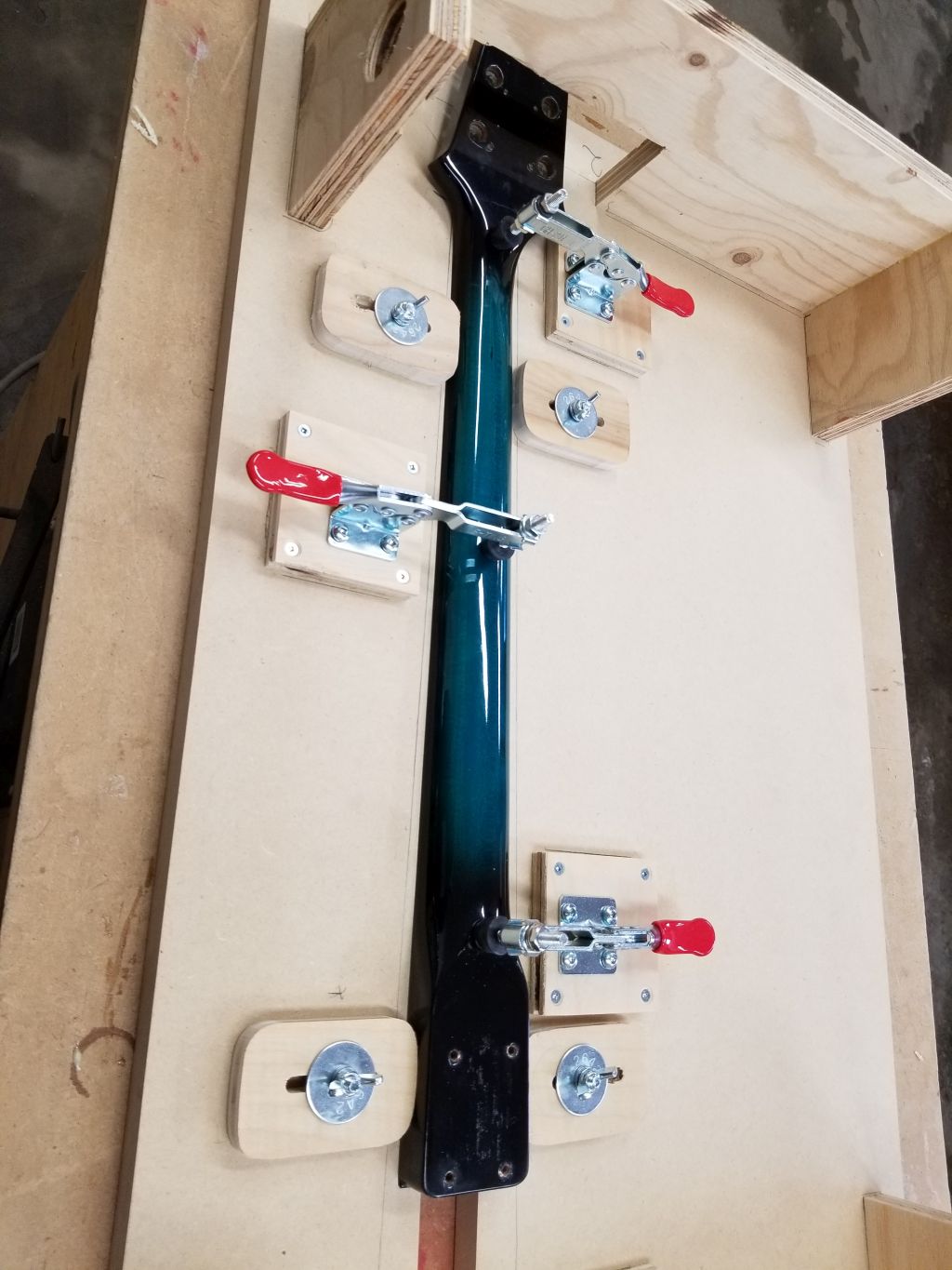

Here is a shot of the bottom where the neck gets clamped. Here is a shot of the top with the tool guide and home made router base.

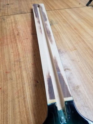

Here is the neck after routing.
Then it's on to routing the new narrower (1/4 inch) truss rod channel.
And here it is with the new channel filled. Just a bit of sanding to level it. Then it's on to routing the new narrower (1/4 inch) truss rod channel.

Nice jig creation, I cut all my truss rod slots on the table saw, which obviously would also need significant jig work. I need to embrace the router more, but they scare the heck out of me.
- Posts: 1188
Re: Neck Rebuild
Brian,
Once you have a proper jig and a way to really control the router, such as this guide, routers are not so scary.
I like this jig as it allows me to work on necks that are already built.
On a neck that is under construction, it has been easier to use a router table.
Now that I have this jig, I can use it for either; and it makes it easy to rout for carbon fiber rods also.
I built the removable stand tall enough that I can put an acoustic neck into the jig, and long enough to do a bass neck.

Let me echo Gordon's comment. A gude for the router as pictured is a huge game-changer. I discovered guided routing a few years ago, and I was amazed at the confidence it lends to the operator and the quality of the results.Brian Evans wrote:Nice jig creation, I cut all my truss rod slots on the table saw, which obviously would also need significant jig work. I need to embrace the router more, but they scare the heck out of me.
Gordon - whose guide system are you using there? That looks really nice!!
- Posts: 1188
Re: Neck Rebuild
That is the Veritas Edge Guide system sold by Lee Valley.
It has distance stops that are easily adjustable also. It clamps to the edge of the surface plywood.
I made the router base from a small piece of lexan, but you could use plywood if you wanted.

If I was to build this jig again, I would add an edge guide with an added axis of adjustment.

I have a bunch of parlor restoration projects on the go, and I've been avoiding this step due to my overly 'healthy' respect for the router. So I really appreciate the photos for this jig design.
My question for all using such a jig, is what tips or instruction can you give with respect to siting or placing the neck in the jig? Are you simply marking the slot location on the fretboard and then visually lining it up in the jig? Or is there some other trick?

Good questions John. Turning a non-plunge router on and trying to set it down in the jig is difficult and prone to uncontrolled cuts. My setup deals with these problems by using a plunge router and stops at the end of the cut. I prefer to never have the router cutting wood without the positive control of a fence, template or stop.

Yes John, the neck is clamped underneath with the required slot marked.
I then simply center the bit on the mark, and set the end stops.
In my jig the bottom base can be removed, so the jig could theoretically be used on an acoustic guitar with the neck still attached.
I say theoretically because I have not tried it that way yet.
