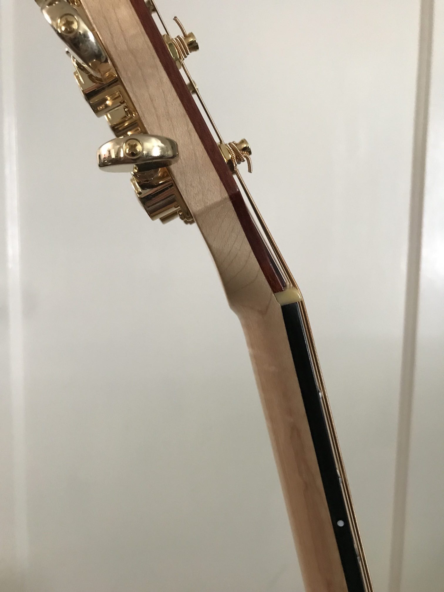

Volute shape
Post by Steve Sawyer »
I just finished carving my first volute in this Lester I’m building. Seems to be in a good spot, but I’ve never played a guitar with one, and don’t have another to compare to. When fingering a 1st-fret barre (F or Bb), my thumb sits right at the transition from neck shaft to volute. It seems to feel ok - not “in the way” - but not being fretted or strung, I thought I’d ask if that sounds right.
Thanks.

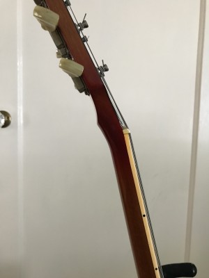

Re: Volute shape
Post by John Clifford »
Here's what my '70s Les Paul Deluxe looks like. I'm not sure I would copy this shape if I was making one, and I don't think it needs to be that far back. But I agree that the crest of the volute should be at or behind the nut line.

Steve Sawyer
Posts: 965
Location: Detroit, Michigan
Re: Volute shape
Thank folks. I too put the crest right at the nut. Just trying to gauge whether the slope to the shaft is too long. From that side view above, it looks like I’m in good shape.
Glad I could ask a question leading to such an historic internet milestone!! :D

John Clifford
Posts: 180
Re: Volute shape
Hmm - maybe Gibson knew what they were doing?? I do a little mini-volute like this, more for aesthetic reasons than for strength. I sort of balk at the idea of designing a guitar to withstand being dropped on its head. But that's probably because I'm a hobbyist, not a factory with hundreds of thousands of warranties outstanding!
