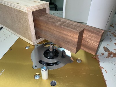

I have a question, but my main purpose is to share how I cut this tenon. It's not my technique, but something that I picked up from some guy on YouTube a couple of years back, with a minor modification.

I made a box just wide enough to accept the still-squared neck, and sliced off one end at exactly 1 1/2°. The idea is to create an angled surface against which to run a top-bearing router bit to get the tenon shoulders at exactly 1 1/2° The guy I saw do this then secured the neck within the box with wedges. I didn't like that (and my test neck is a bit twisted, which is why it's a "test neck"), so instead I bored three holes on each side and tapped them for 1/4-20 set screws and this worked super well.

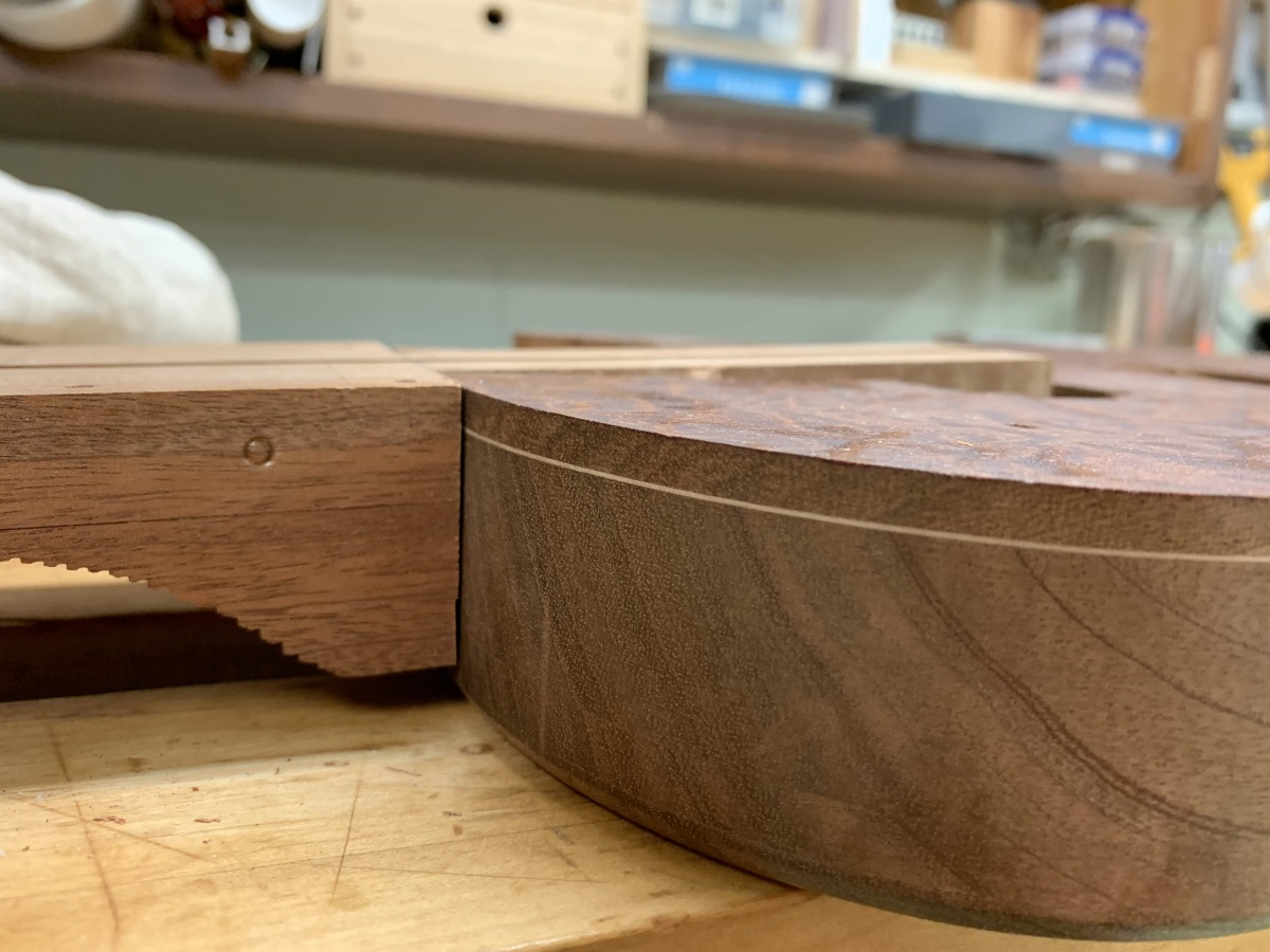

Once this is all put together, I just run the two sides of the body-end of the neck across the router bit in the router table/extension. I had to change bits at one point to get enough length to do the job, but on the final cuts I kept cranking up the bit in tiny increments until the tenon was just narrow enough to fit into the mortise. I repeated the process for the bottom of the tenon. Because the bit is vertical, the angle on the end of the box does nothing for me when cutting the bottom of the tenon, hence note the tiny "step" visible between the heel and the body in the third picture below. When I do the "real" neck, I'll put a couple of layers of tape or maybe stick a piece of veneer on the bottom of the box so I can go back and do a bit of fine chiseling to clean that spot up. Also, note that while the angle is perfect, because the body starts to curve a bit, I may need to do a little bit of undercutting to get that joint to close up. I'll wait until I've band sawed and routed the neck to the final profile as that will reduce the size of that gap.
All in all, this technique worked extremely well. One thing I'll do before doing the next one is make some kind of pin or wedge to lever the neck against while running the router bit cross-grain across the width of the tenon. The little post that is made for the router plate I use (visible in a couple of the pictures) is much too short and much too close to the bit to work real well. I ended up putting a long bolt and a stack of nylon spacers into the T-track strip you can see in the first pic, and that worked better, but I can improve on it further. I could also use a miter gauge.
