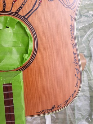

Hello all! I found some very helpful comments from a older thread, and was encouraged to start a new feed.
Customer requests a painting on his Takamine acoustic, cedar body.
Tattoo-outline minimalist style, creating a dreamcatcher from the sound hole and branching into an eagle near the base.
The office at a California distribution center said they used a light polyurethane for this model.
Customer initially was against sanding but I've gotten great questions and comments from the finishes thread which bring to mind how the substances will interact and adjust over time. I'm waiting on word as to whether the customer will allow me to sand back the entire panel, complete the painting (designed to convert the smallest amount of surface area possible), and refinish over everything to keep it consistent.
My final battle I believe boils down to process: for those of you who restore or have worked with "mixed media" instruments, what are your recommendations before I even touch this guitar?
I will have a full day to myself to complete the work and let it cure. He's moving north in less than 1 month so we decided to wrap this up to let it settle into it's changes as early as possible before traveling.
**The paint isn't going along the edge where a pick guard usually goes. There never was one^.~
Thanks!
Thanks!

Re: Artist seeking expert advice! Projected deadline 4.27.2019

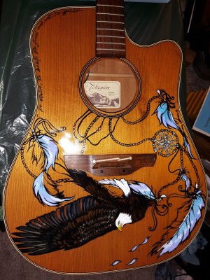

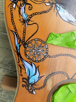

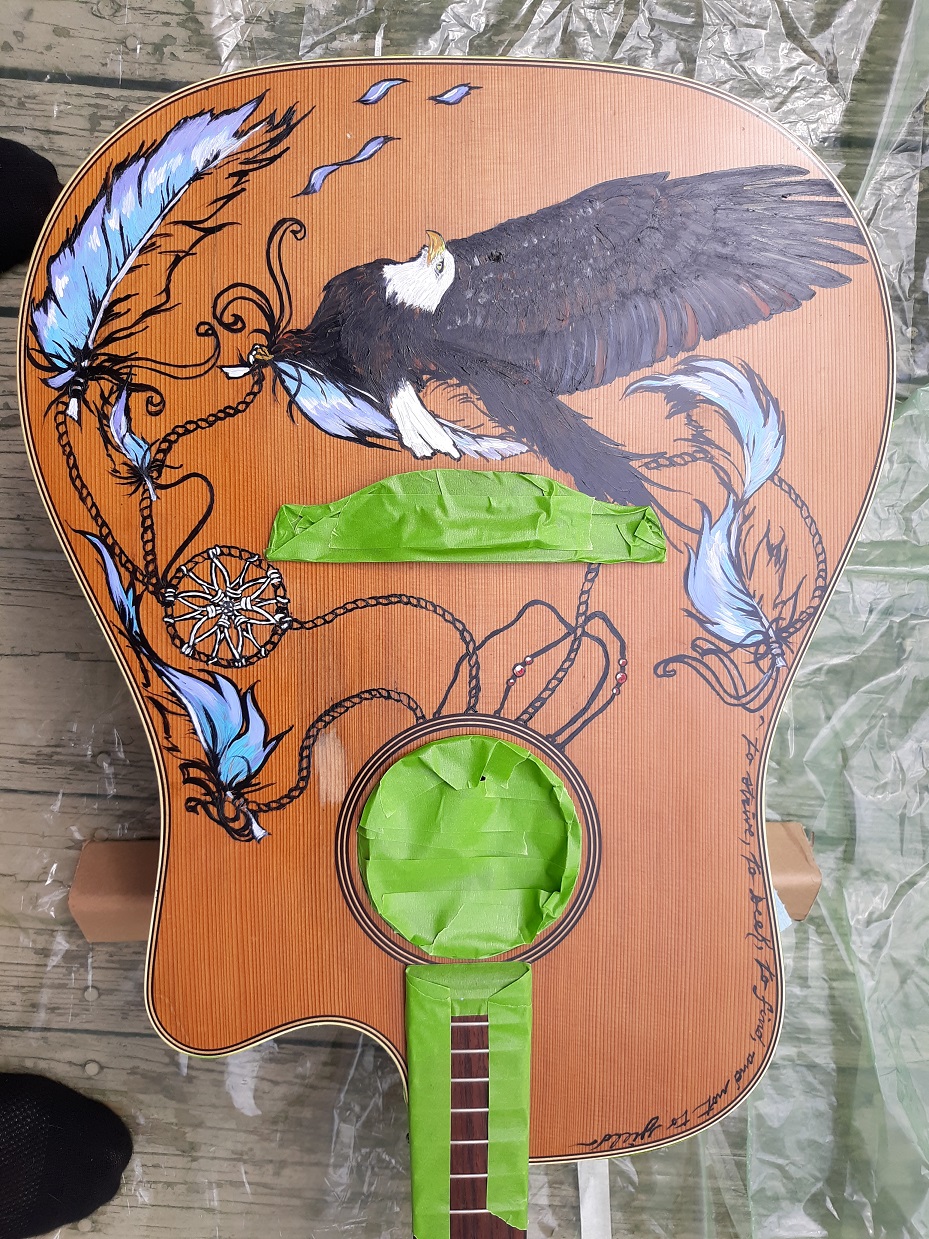

Hello, makers!
FINALLY finished this damn project.
Here is a poorly lit shot of the after-poly, due to the storm which sprang up immediately following sealing and staging this thing to dry on my apartment balcony…>.<
Removed strings
Detail cleaned
No loose finish from original build, so didn’t sand first
Handpainted over the course of the past 2 days straight. Literally about 16 hours.
Was lucky the original finish was a gloss because that allowed me to simply wipe back acrylic details that weren’t to taste…customer was questioning through ALL the progress shots yesterday ssooo never doing that again, and tadah!
Lined with FrogTape and shop towels
Set outside and poured clear coat Satin finish polyurethane by Minwax (NOT my favorite, but was attainable with this deadline>.>)
Seems to be setting up smoothly, was able to foam brush the finish with minimal bubble drama
Now this damn thing is showing a shadow over the whole streak where the player had been wearing down into the wood where a pick guard would usually be. I worried he’ll freak out but this smudge is where I was attempting to remove pencil and paint, but it smeared to far into the chipped area, and it seemed very nearly normal color until the finish settled in an hour after pouring.
Am I screwed? He loved the picture, but now it’s darker there. Wish me luck…
Hannah
Removed strings
Detail cleaned
Hannah

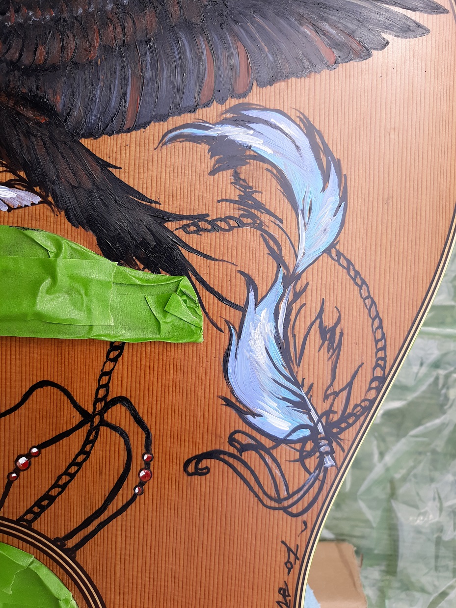

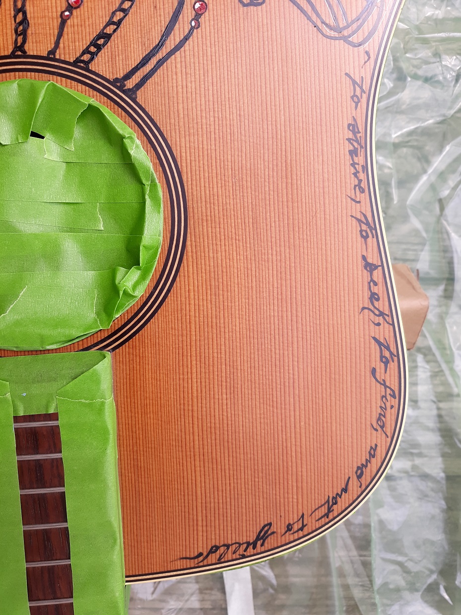

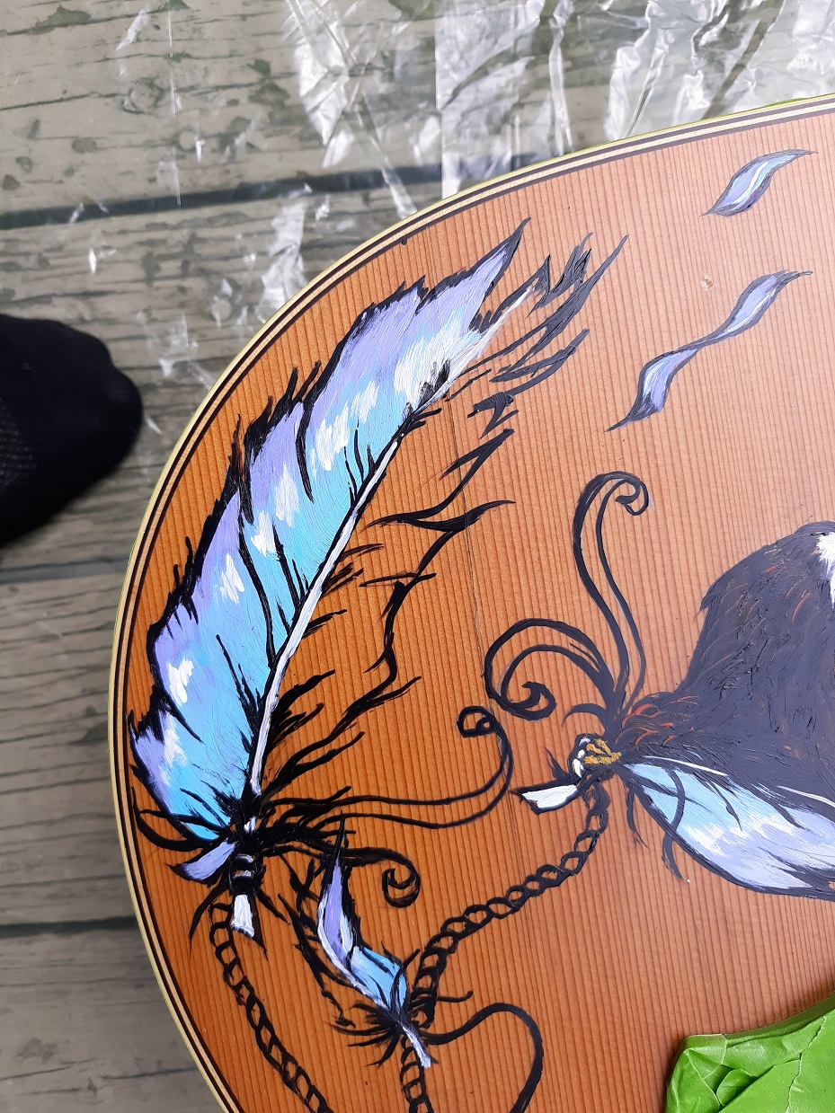

Sorry, trying to attach images, this should do it!
~H
~H

Wow - to add to Bob's/
Excellent art - many of us are jealous of your ability to lay that down in 2 days. Looks great!
Your "bad spot" needed to be sealed before you did the whole overcoat. Is it rough? Did the Minwax finish raise the grain of the spruce? The color does not look too bad, but the texture looks rough.
If the wood is damaged there from pick wear, and it still looks "pick-worn" then i would just leave it. If the grain is rough due to raised grain, I would sand very lightly to remove the fibers. Then it is your call if it needs to be recoated - or left.
He should not freak out - that is a pick-worn spot - damaged spruce is generally left alone because there's not much you, or anyone, can do to repair it.

Thank you!!Chuck Tweedy wrote:Wow - to add to Bob's/
If the wood is damaged there from pick wear, and it still looks "pick-worn" then I would just leave it. If the grain is rough due to raised grain, I would sand very lightly to remove the fibers. Then it is your call if it needs to be recoated - or left.
This spot may not be reparable physically, but I wish I'd gotten the damn darkness out before it saturated. Ugh. Yes, maybe sanding back in tomorrow evening would pick up the dark fibers and I could touch it up with clear. He knows it's beaten up but I hope he's not bothered by the new shadow. Just looks dirty that's all. If I mess with it won't the finish create edging issues or just sink in nicely? Turns out I grabbed an oil base after all, probably fine to manipulate.
Regarding the paint timeline, the DRAFT alone took 9 hours to tweak and a sharpie for Jon to review and approve the final design. The painting was awkward; not realizing the acrylic viscosity was wrong without keeping it slightly watered down to make it glide across the damn preexisting gloss made for many ugly edges, BUT the lack of "tooth" allowed for easy wipe removal of screw-ups with a damp cloth.
This you see now ended up being collectively redone about 7 times. I think. Probably more.
Anyhoo...Now that I have a thorough understanding of what type of brush to provide proper line control, what viscosity to go for, and wise prep procedure, I feel ready for just about anything^_^
I'm based in North Carolina and have reserved my off days, Friday and Saturday, for such commission work. I've always found myself digging into the local music community from singing at open mics to sharing lyrics with my dear friends who play far better than I.
You've all been wonderful help!
Goodnight!
Pre-pour clear daylight shots^_^
- Posts: 1182
The guitar has a top crack in the lower bout (between the eagle and the feather) that should have been taken care of before you painted. But that is water under the bridge now.
the pick worn spot will just get beat up again, but you put some finish there to slow down the future damage.
A water-based finish will darken the raw section of grain by the sound hole when wet but should lighten up as it cures.
I think it looks great all around.
