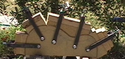

Hello All,

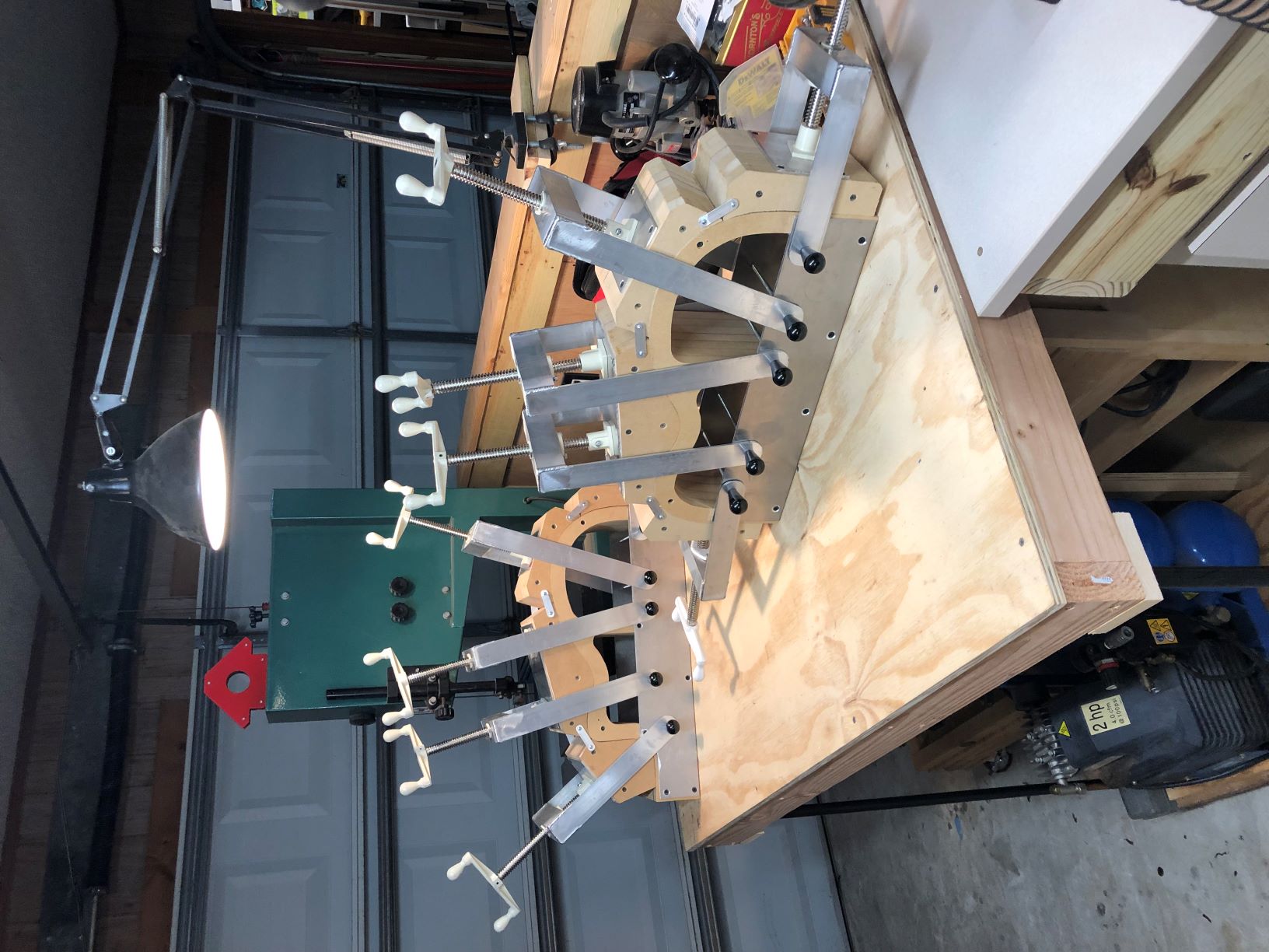

As the traditional construction method for Gypsy Selmer style guitars is to laminate, I have used both inside and outside bending/laminating jigs. My first jigs were an inside type that I had copied from Michael Collins' book and videos. This worked well although a little cumbersome when it came to flipping it over to add clamps. It uses a body form and an inside caul.
My second jig, an outside type as pictured herein, is taken from the original Selmer jig as shown in Francois' Charle's book on Selmer guitars. Their jig was a rusty, well-worn apparatus with lots of character so I decided to replicate it. Mine is built using aluminum and single press clamps. I like this so much more than the inside jig and it produces a good, even clamping pressure. Yea, it seems a bit much for my small non-production shop but I had the materials and some time and it was fun to build. It should last until I'm long gone!
The picture looks sideways so click on it and it'll open up.
Regards,
DJ

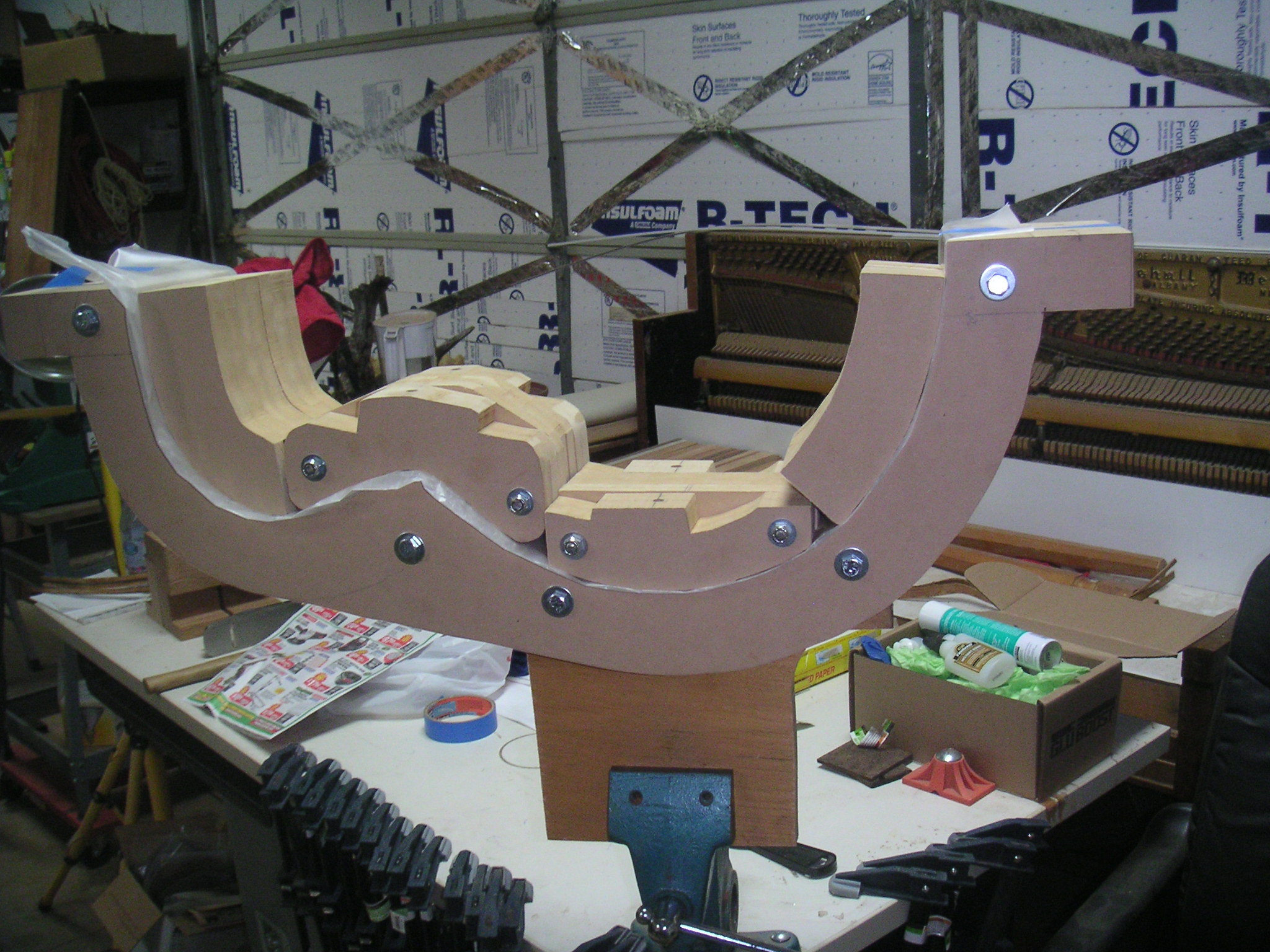

Here's my take on a side laminating form.

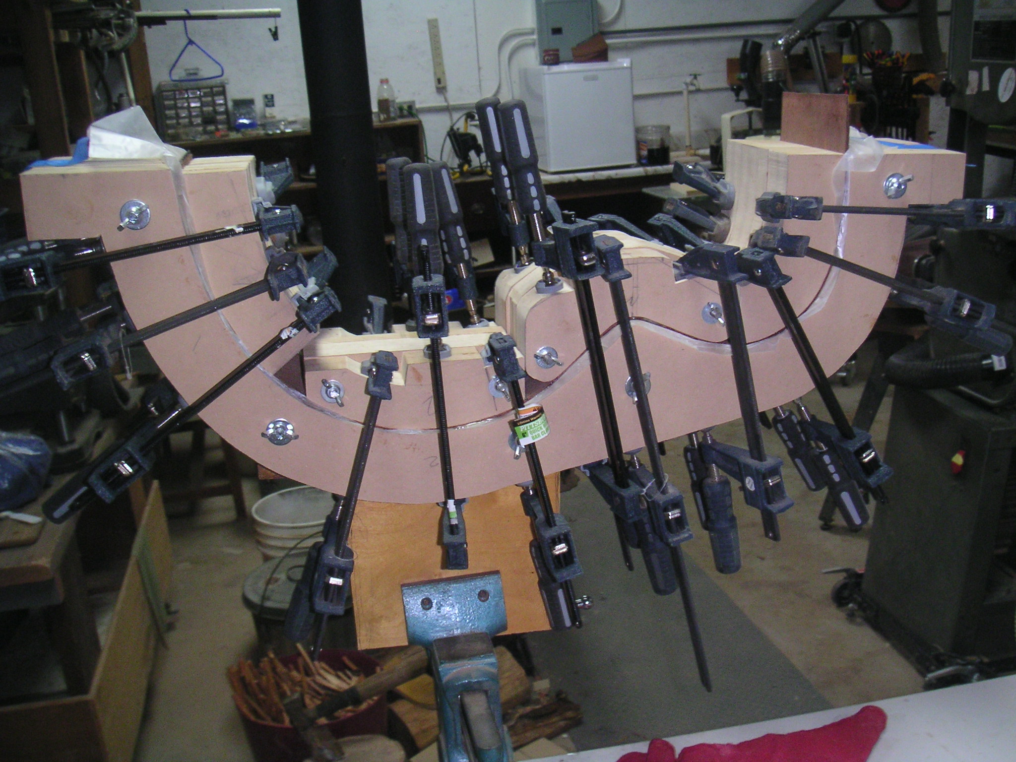

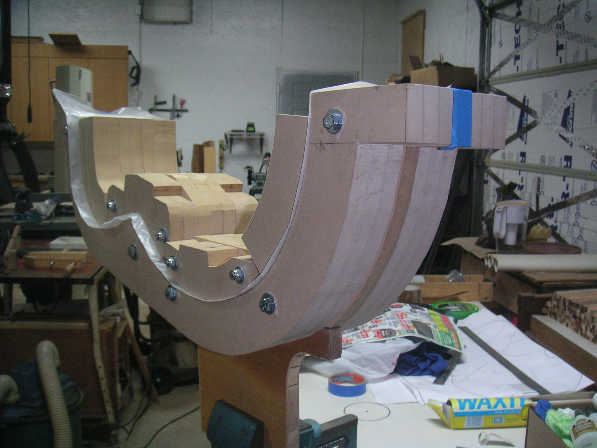

Here's what I put together... outside mold bolted together with a spacer and extension to go in the vise. Inside waist and lower bout spreaders bolted with spacers and other scraps glued to make the cauls, clamped with 25 HF clamps.
An addition for the next time I use it will be a sheet of scrap formica to even out the clamping pressure.

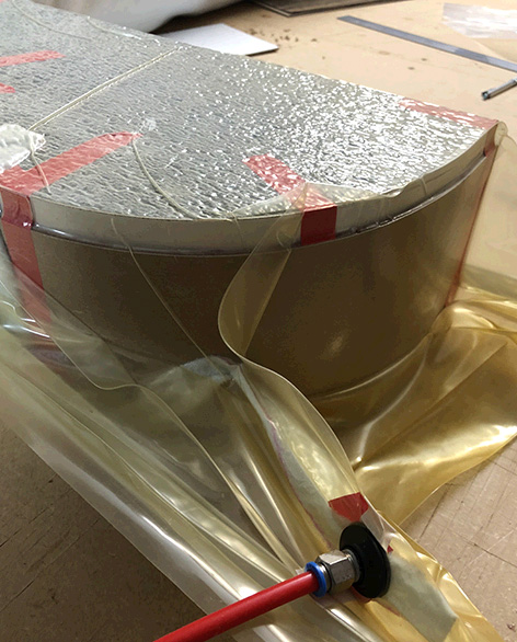

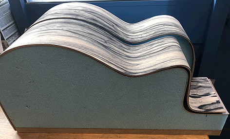

Different approach but here are the moulds and sides I vacuum laminated in white ebony. PTFE coated cloth on top of the polystyrene mould and a similarly coated caul of 0.8mm birch plywood on the outside. The lamination of 5 layers of veneer (three long and two cross grain) were bonded with a UF resin which has about an 8-10 hour cure time so no worries about it starting to go off before everything's under pressure. The small amount of spring back takes no effort to push back to the mould shape.The three internal layers are mahogany and i have used figured sycamore fo the inside and it should all look fairly pretty when its finished I think.
