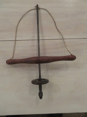

Pretty remarkable. Or I could sell you both of mine for $25 each:
Ed
Ed
