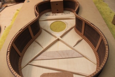

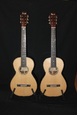

I have built three parlor sized guitars from the Antes plans, similar but different. The first was Sitka over EIR, it was a present for my daughter and I'm ashamed to say I screwed up when I built it. The Antes plans are drawn as tho you were looking thru the top with X-ray vision, every other plan I had used was drawn from the back, so my guitar ended up with the single tone bar running the wrong way - it is braced as tho it was a lefty. Funny thing, guitar sounds pretty darn good.
I built two more and got it right this time (pun intended). These guitars were built side by side out of sister cuts of Lutz spruce and same brace wood and neck, however one guitar is Brazilian rosewood, the other is Madagascar. Interesting thing is that when played side by side no one can tell a difference.
OK, lets answer your questions. The Lutz was pretty stiff and I had built a couple of guitars at 0.110 out of it, I thinned it a hair more for these guitars (lets say 0.105). The backs are 0.090, the sides bent well at 0.075 or 80. The Antes plans have a reputation for being over braced, I used 1/4 Sitka for mine, profiled the braces but did not scallop. A smallish maple b/p and pyramid bridge. One minor but maybe important consideration - all three guitars got Style 41 abalone purfling so they had a fairly substantial channel cut around the top edge - I've heard people say this might open the top response a little. Here is the bracing
I'll add two more comments. These are amazing little guitars. While they don't have a huge bass they still are pretty well balanced and a joy to play. I had submitted one of them (the Mad rose guitar) to the Steel String Listening Session at the last GAL conference. As I was walking out of the auditorium a couple of fellows walked up and commented that they really liked my guitar and how well it projected. I asked them where they were sitting, they said the very back.
