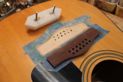

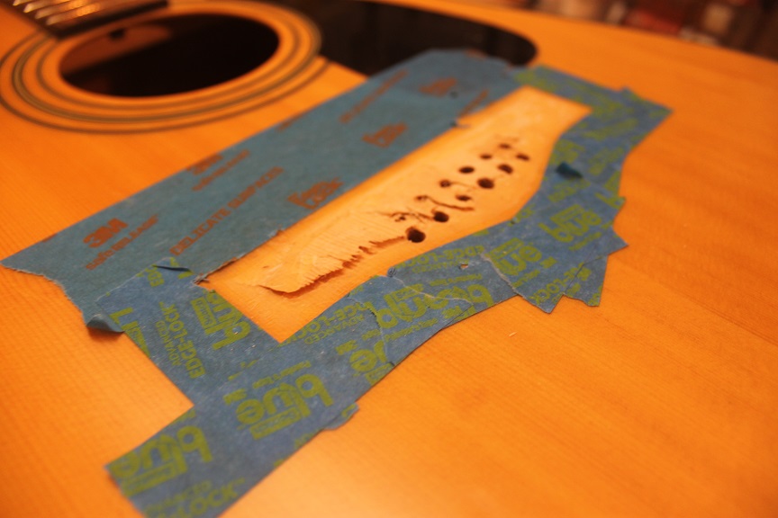

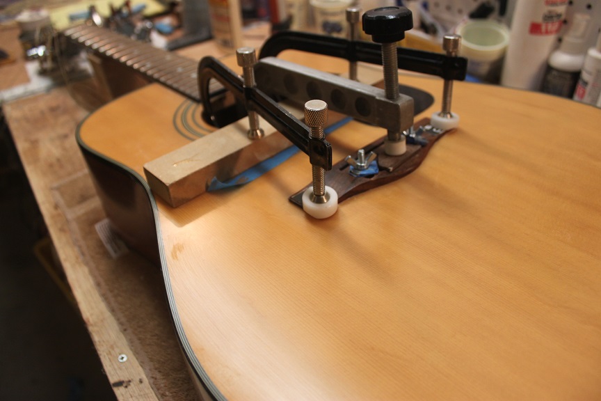

- Posts: 506
Re: Bridge lifting, Guild 12 String
Remove it, remove every bit of old glue, remove any top finish that the manufacture might have left on it (you would be surprised how many do a poor job of prepping it) and reglue it with a good set of cauls and clamps. This, unfortunately, is one of the most common failures I see but it can be fixed correctly.Andrew Porter wrote:Thanks for the responses.
Brian - Good to know. On a guild by chance?
John - This looks like an easy job except for the caveat you mention. I wonder if super glue or epoxy might work.
Fwiw, I just had 3 at the same time, a Fender 12 string (factory left a lot of finish on the top, where they did clean it off it pulled the top ply of the laminated top loose), an Epiphone classical that some bozo tried to fix with epoxy (I charged extra to clean up the mess he left) and a charming little '63 Gibson with one of those bad idea plastic bridges (I fitted a new rosewood bridge with HHG).
Here it the Fender as it came to me and ready for the glue up
The white thing is a piece of industrial plastic called UHMW that fits between the X brace. It is adjustable for different pin spacing and locates the bridge with respect to the pin holes. It also provides a non stick internal clamping caul. I do enough of these that I machined several different UHMW cauls
