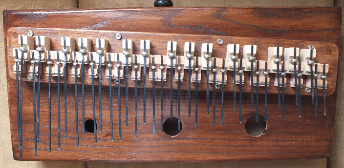

Peter, Thanks so much. That was just about 1/5th of the tines I need to install. Now that I have a pretty good idea how things go, I have been working on the shorter tines. Took me almost two hours to get seven done. So it will be a very long process
This is how I ended up on those seven tines that are made up of electricians 1/8x.062 fishing tape. The first is of course the note, and the number is how long they are in millimeters. Bb 94, F# 90, G 88.5, G# 87, A 85, B 82.5, C 80.5. I will continue to post these notes and lengths so that anyone wanting to do something like this has a starting point. Unfortunately I do no know what octave this new set is. I did not purchase an orchestral chromatic tuning meter which would have given me that information.
Just to let those know, these are unmodified tines. I did not grind them down any, other than to cut and round the ends; no indentations. The first ones i did, which are what is on the audio clip, those did have indentations made to bring them to tune, and those are basically the only ones that gave the strongest resonance. It may very well be that I may have to do the same to thin these down, which will change the notes. I guess I should do one tine below the ones that sound good to see how it sounds with the indentation modification. If it should resonate better, then I need to make that the norm for all of the tines.
Still learning how things work. CaleyAnn

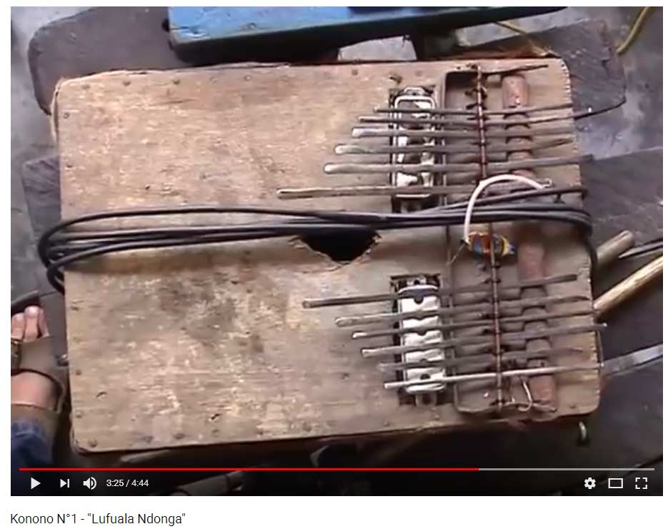

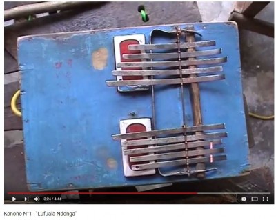

I spent a couple of years in equatorial Africa in the 1960's, and brought a kalimba back, though I can't find it now.
Here's a couple of videos of Congolese music from the late 20th century that I've enjoyed for a number of years (first found on a BBC program called World Music), prominently featuring amplified kalimbas. The social aspects are interesting too.
https://www.youtube.com/watch?v=vJFpYV-Aw9Y
https://www.youtube.com/watch?v=Los0qjV9Ecg
And a couple of screen shots of the instruments (get yourself some guitar pickups to add.) :D

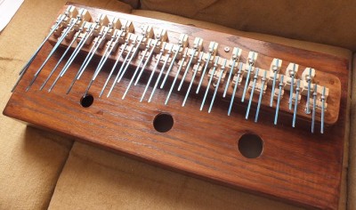

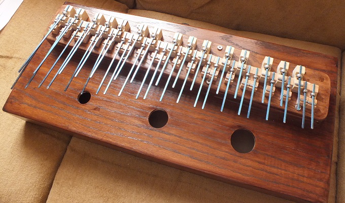

Gents, my first attempt at building a musical instrument from scratch is done. Well, phase 1 is done. I am still trying to figure out how to get the shorter and longer tines to sound better. They sound weak, but for the most part I am happy
I have included two photos of the semi finished product, and a short sound burp of what the lower tines sound like.
I definitely need to figure out how the professional builders can make an array Mbira or chromatic Kalimba, that have strong resonance across the entire board. I'm sure they won't want to divulge their secrets, but somehow I need to figure it all out.
I will not be plucking on these tines too much for the next few days, as they have worn out the skin on a few of my fingertips. Maybe later I can try to learn how to play something easy like, "Ode to Joy" CaleyAnn

I think I have figured how to get better resonance on my tines, to the right hand side, or about the last 12 tines. Seems that the middle ones work fine without any modification. But the shorter ones were basically thunking when plucked.
I had built a much small sound box out of a scrap piece of 2x6, about 10 inches long. I had hollowed it out as best I could, then slapped on a piece of the scrap maple panel I had used for my Zither back replacement.
I cut some shorter tines, then ground the underside down about 2/3rds the way through that tine. With that modification, there was a marked difference in its ability to send a vibration to the sound box, a much cleaner, sharper sound.
Lesson learned is that these thick tines cannot just be slapped on, but need to be modified somewhat to make them work.
As for the longer tines, I doubt I can make those work. I think their length is well beyond what is useable.
So it may very well be that I will have to create a whole new set of shorter tines with the underside modified, if I ever want to get this larger Kalimba to actually work completely across the board. CaleyAnn
