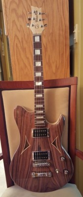

- Posts: 1188
Re: Clear Finish on Rosewood?
I finished this guitar a while ago, and the Pau Ferro finished beautifully. I simply sprayed lacquer on it.
I did not have any reaction whatsoever to the dust.

- Posts: 1188
I finished the Pau Ferro by simply spraying water based lacquer on it. No pore filling needed.
Again, I did not experience any untoward physical reaction to the wood, or dust.
I was careful, using gloves, and a dust mask EVERY time I worked with it.
- Posts: 1188
Here is a pic that shows how the finish ended up.
