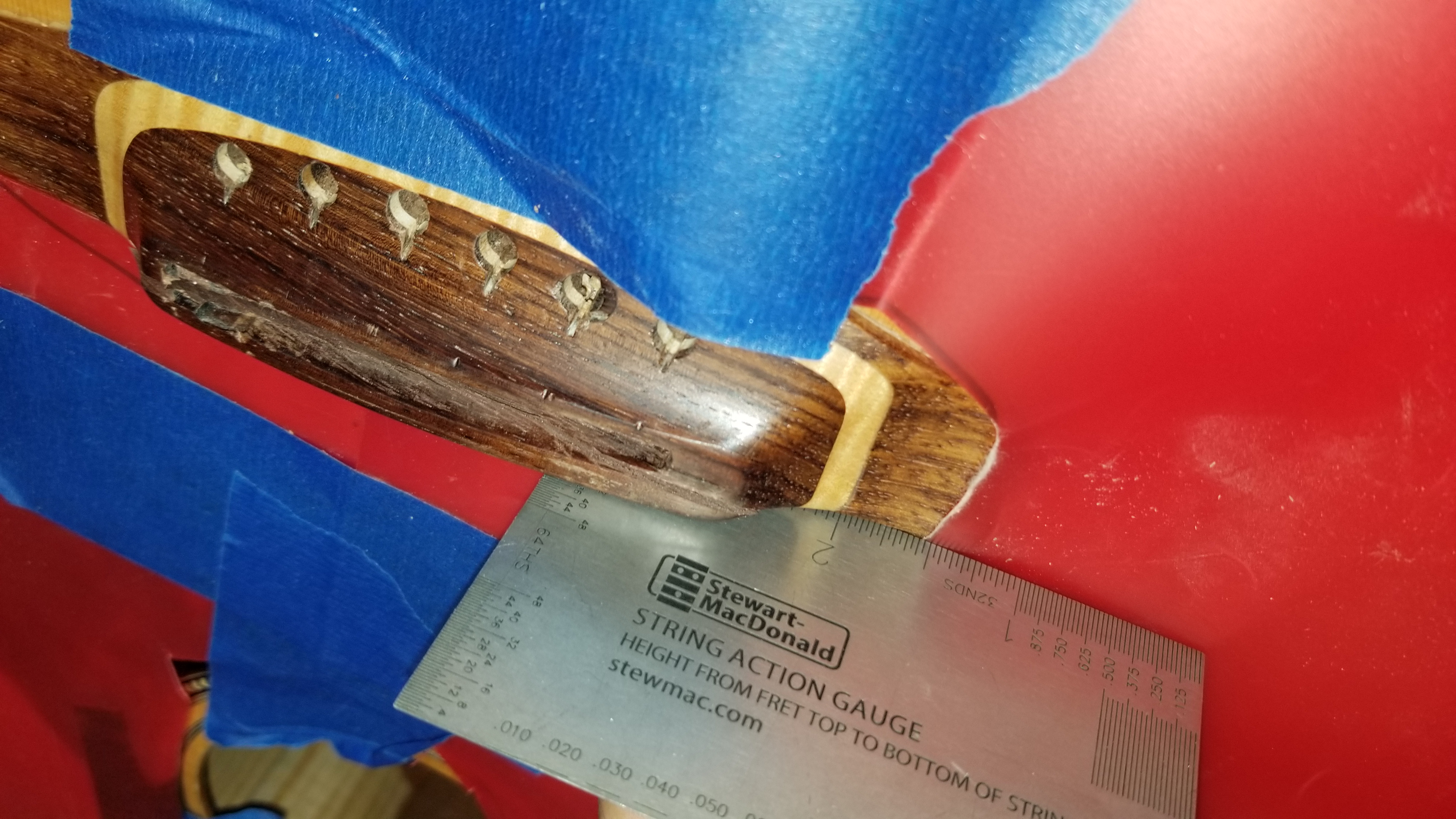

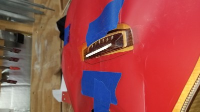

I am repairing a curly maple b&s and neck om size guitar with a 3/4" tall bridge, yes 3/4, with a saddle recess less that 1/4 inch deep and it is canted toward the head stock. I needed a very tall very tall saddle in the shallow saddle slot. So, guess what/ the front of the bridge cracked. I think it might be best to just make another tall saddle and route a deeper slot and try to find a very tall saddle bone. What do u guys think? The neck angle is also very very wrong obviously. I could do a neck reset I suppose but this is way way off neck angle wise. It is a bolt on neck.
see photos

image got rotated when uploaded, sorry.

Back to the original post, when I saw it my reaction was to get the instrument stabilized and repair any structural damage. Then set the neck geometry based on the top of the bridge, just like always. Then fit a saddle that has at least 2/3 of its total height buried in the bridge, that might mean routing the slot deeper.
The builder must have had a reason for making the bridge the way he did but playable geometry is the same as any other guitar.

The builder made that bridge intentionally - I would duplicate it. I would be very tempted to try routing the slot out deeper and wider, then filling it with rosewood, then route a new slot (like we do on the old martins when the slot needs to be moved or some of those old guitars with the adjustable saddle inserts). As far as the saddle, if it sticks out 1/8 inch it only needs to go into the bridge 1/4, but I would be temped to make it deeper. Just get a taller piece of bone.

If you don't want to reset the neck, I'd fill the slot and re-rout it so that the saddle tilts backward. This can go a long way toward reducing the tipping force. In fact, if the saddle angle bisects the break angle, there is no tipping force. That's how violins get away with those tall, narrow bridges.
Having the strings so high off the top does put a lot of torque on it, though, and angling the slot back doesn't change that. I'm amazed that top is not more distorted than it looks to be in the photos.

the front of the saddle slot on the bridge has essentially broken off so I would have to rely on a glued back saddle and saddle and the back of the saddle is really not conducive to clamping forces due to exaggerated slope. I'll see what my friend wants to do.

It looks like the bridge is laminated from three pieces. Applying heat would worry me that its going to come apart where you don't want it to. Can you plane the top piece off and make a new one? I can't tell what the pin holes would do

Using something tough like African blackwood to recreate that top layer will minimize the possibility for the leading edge to snap off again. It'd be tempting to remove that curly maple layer in there as well as I can't imagine that it's doing any sonic favors. I usually mill my saddle slots with a 7º back angle to split the break angle a bit closer to 50/50. It can obviously make intonation tricky so I wouldn't go much over 7º. The angle will move the slot forwards so I'd try to add more material in front of the saddle in your new bridge design

It there is an option at this point, I'd take a pass on this repair. With that sort of excessive string height over the top and a traditional pinned bridge, nothing good lies in store for that instrument. At some point, the owner may associate your efforts to address the immediate issue with all of the problems that - given the builder's 'choices' with regards to geometry - seem guaranteed to occur.

I would fit a wedge under the heel to get the neck angle back to a semblance of reality, rout or plane the bridge down to somewhat normal, check the scale length and rerout the saddle slot in the proper spot. (You might also want to place a tag in it written in Hanzi to give yourself some plausible deniability ).

all interesting ideas. The wedge idea might work. I think I might just make a whole new bridge. What about a neck reset? Too much back angle to correct? This is an undemanding friend of mine and he built this guitar with a "luthier" Man, mistakes include bridge pin holes that are no reamed enough for the ball end to pass easily, this bridge, loose saddle slot. I would have rerouted it but I could see how to stabilize my stew mac plastic saddle slot jig at that height while the bridge is on the body. Amazing break angle at this height. Obviously digging in to the saddle too which had to be very sharp. etc. etc.
