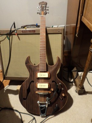

walnut semi hollow body
Walnut neck, back and sides.
Cooked osage orange fingerboard.
Hickory binding and linings.
2 P-90 style pick-ups made by MJS
1 volume, 1 tone, 3-way pick-up switch and master series parallel switch
Bigsby!

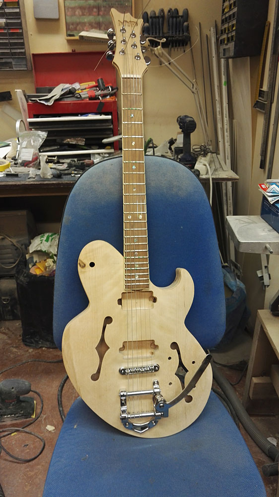

Re: walnut semi hollow body
It has a neck substantial (spruce) neck block in it that ends somewhere between the pickups.
The top and back are carved - like and archtop, but the arch is shallower. My blanks were about 9/16" deep.

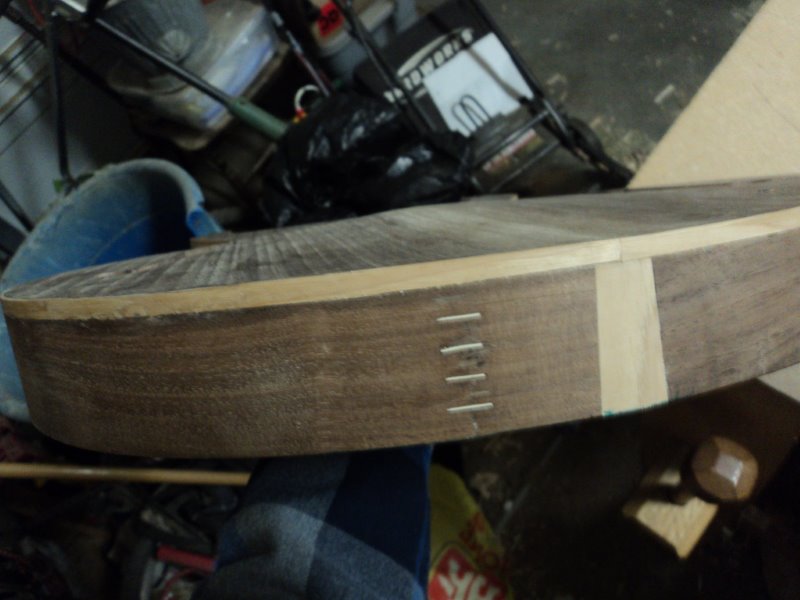

Here's the back:

I learned a lot making this guitar. In particular I improved my chiselling technique. (See instruction for using a chisel in jam session...). At one point one of my rims split, so I glued it back together, a little imperfectly, so I knew the "scar would show a bit, so to commemorate my had injury (no lasting effects, thank goodness) I inlayed 4 "stitches" where the break had been. They are purely for looks/entertainment. the heel block is behind the break, so there's not a structural problem there. Here's a construction picture of that:

That looks delicious!
I love the stitches. What a great way to memorialize the injuries to yourself and the guitar. I'm glad the hand is going to be okay.

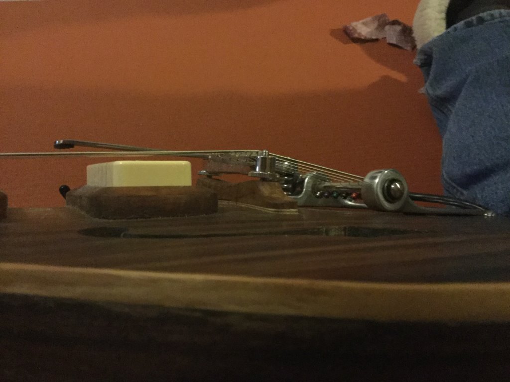

My guitar has a regular tune-o-matic. I couldn't find a suitable roller bridge, so I went with the regular one. Gretch often seems to use the regular ones, and from what I see, they are the guys who sell the most guitars with Bigsbys. I haven't found that I have any real tuning issues or anything with the bridge as it is, so I'm thinking in this application, while a roller bridge sounds like a good idea, it isn't really necessary. It may depend on how you use the Bigsby though. I'm not a real whammy bar guy, so mostly I just use it for a gentle wobble when I remember it's there. Sometimes I think I might be happier with the sound if I replaced the saddles with those tusq ones, but I'm still sorting out what strings I want to use and getting used to this guitar in general, so I haven't started changing it yet.

Freeman, that's spectacular! My bridge is more like this one: http://www.stewmac.com/Hardware_and_Par ... uitar.html
except that I made the bottom part myself. I see bridges that look like that on lots of Gretch guitars these days. All the roller bridges I saw seemed to be made for a different (larger) post style, so I bought one that works with those little thumbwheels like in the picture. My guitar has substantial braces under the bridge, but the block stops short of the neck pickup, so I wasn't comfortable sinking those big posts into the top.
Do you think the rollers improve things somehow? The idea seems good, but I really can't say I've found the regular bridge to be an issue. Another difference between mine and yours is that my Bigsby is a different model that doesn't have that bar in the front that the strings go under. I have what I consider to be a reasonable break angle over my bridge which was a concern to me. I must say I was surprised at how shallow the angle was on the Gretches I looked at. I'll see about taking a picture to show that part of my guitar.

Here's a side view of the bridge. Hopefully you can see the break angle and the type of posts on the bridge I'm using.

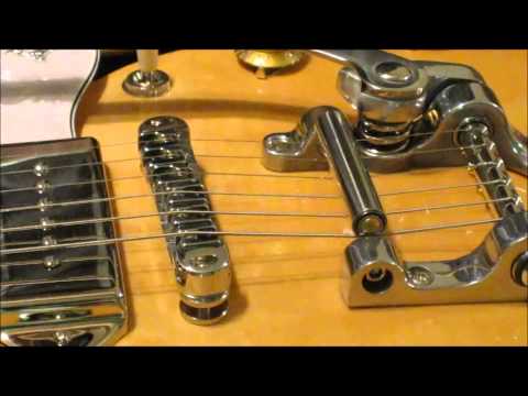

Here is something I found while doing a bit of research on Bigsby Vibratos.
If you look at the front roller, you will see that it is extended upward. This of course causes a more shallow break angle, which they say lessens tuning issues.
I can see this working on shorter solid body electrics, where the distance between the vibrato and the bridge could be an issue.

Jim Hepler wrote:Freeman, that's spectacular! My bridge is more like this one: http://www.stewmac.com/Hardware_and_Par ... uitar.html
There are several different Bigsby designs depending on the shape of the top and whether there is enough wood to mount it to. The only one I've used is the B70 which does have two screws into the top and requires an internal block. I know that there are lots of Gretsch and other semi hollows that have floating bridges like yours and different vibratos than the B70. They seem to work fine.Markku Nyytäjä wrote:Thank you for your replies, folks.
