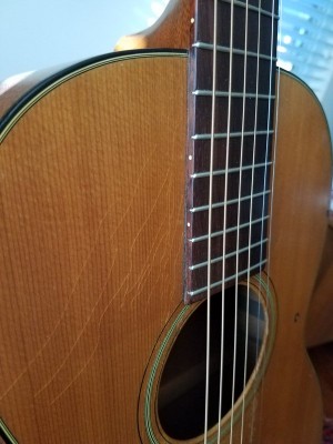

If there does end up being a gap when the fretboard is straight then I put in a wedge. Here's one on a late 60's Martin size 0.
