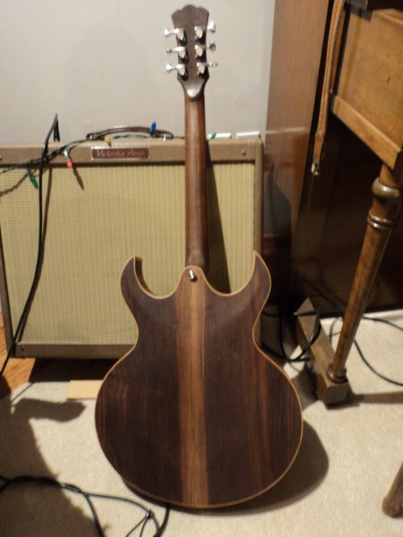

Here is my latest:
Walnut neck, back and sides.
Cooked osage orange fingerboard.
Hickory binding and linings.
2 P-90 style pick-ups made by MJS
1 volume, 1 tone, 3-way pick-up switch and master series parallel switch
Bigsby!

It has a neck substantial (spruce) neck block in it that ends somewhere between the pickups.
The top and back are carved - like and archtop, but the arch is shallower. My blanks were about 9/16" deep.
Here's the back:

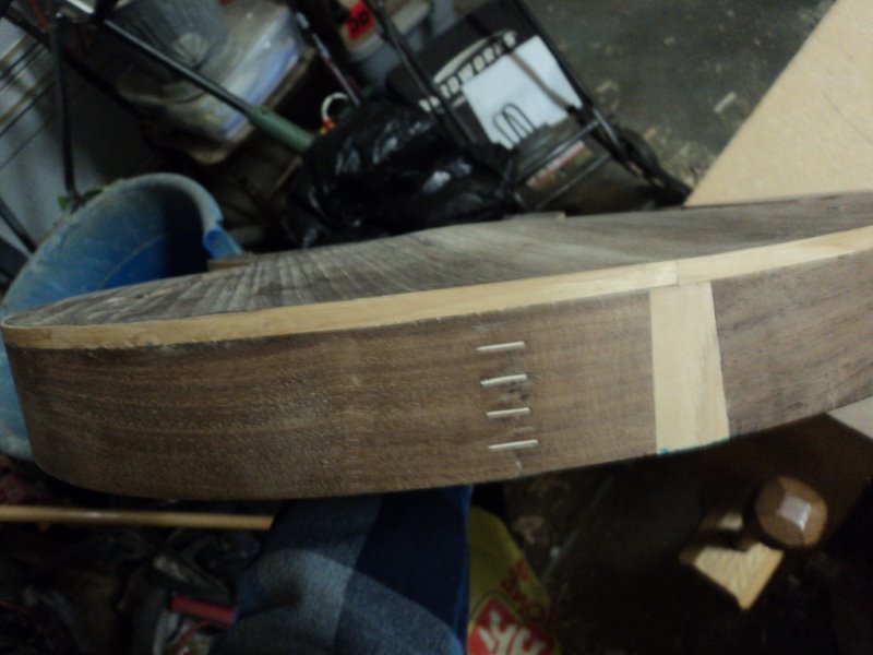

I learned a lot making this guitar. In particular I improved my chiselling technique. (See instruction for using a chisel in jam session...). At one point one of my rims split, so I glued it back together, a little imperfectly, so I knew the "scar would show a bit, so to commemorate my had injury (no lasting effects, thank goodness) I inlayed 4 "stitches" where the break had been. They are purely for looks/entertainment. the heel block is behind the break, so there's not a structural problem there. Here's a construction picture of that:
Posts: 1390
Re: walnut semi hollow body
That looks delicious!
I love the stitches. What a great way to memorialize the injuries to yourself and the guitar. I'm glad the hand is going to be okay.

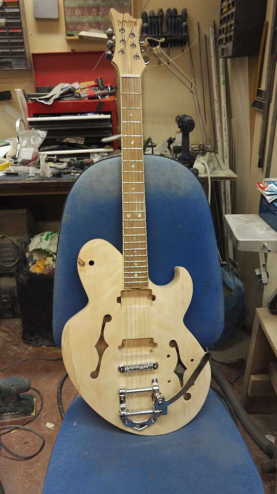

Is that a roller bridge you've used or a standard tune-o-matic? I'm building a semi-hollow six-stringer with a Bigsby type trem and a roller t-o-m bridge - and the 011-series strings keep jumping off the roller grooves when I pick them.

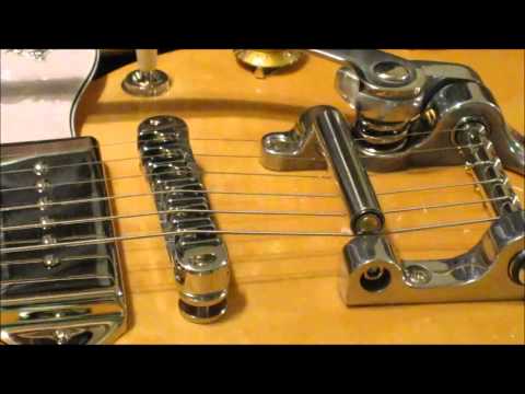

Here is something I found while doing a bit of research on Bigsby Vibratos.
If you look at the front roller, you will see that it is extended upward. This of course causes a more shallow break angle, which they say lessens tuning issues.
I can see this working on shorter solid body electrics, where the distance between the vibrato and the bridge could be an issue.

My break angle may bee just a bit too low for a roller bridge, it might be wise to use a regular t-o-m. It's my first build with a Bigsby type trem, so I still have a lot to learn.
I also have another unfinished project that will have a Floyd Rose type trem, and I have never installed any of those either. Either I'm eager to learn or just asking for trouble. ;)

Thanks, Freeman. That Kahler looks interesting, but I already have a couple of Floyd Rose type trems in stock. I think I'll use them before purchasing new ones. I believe it's good to learn to install and set up all the most common types of trems, They're the most likely ones clients will want to get help with. Maybe I'll get a Kahler some time later.
By the way, the strings have stopped falling off the roller saddles. I loosened the strings to file down some frets and after tuning the guitar again the strings kept in place nicely. That's a big relief for me, now I won't have to replace the bridge. :D
Here's the guitar project, strung and with the Bigsby type trem. The chambered body resonates nicely. Once I have leveled the frets, I'll start painting the instrument. I have hunch she'll become a really nice guitar.
