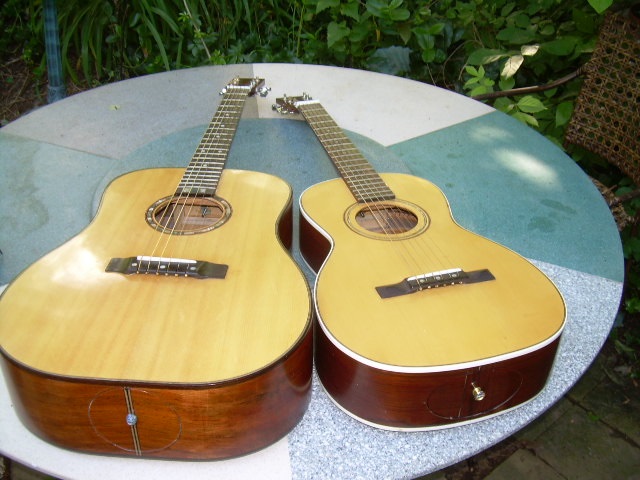

Professional guitar makers quite often have a "test mule" guitar or two, which new ideas are tested out on. I have a couple of guitars of different types that have had multiple tops on. If you do a decent job, very few people would be able to tell that a top (or back) had been changed. Here's one I changed recently. A few weeks ago it had a spruce top on...
This one was done as a "drop in" replacement top, keeping the original bindings.

Trevor Gore wrote:Professional guitar makers quite often have a "test mule" guitar or two, which new ideas are tested out on. I have a couple of guitars of different types that have had multiple tops on. If you do a decent job, very few people would be able to tell that a top (or back) had been changed. Here's one I changed recently. A few weeks ago it had a spruce top on...

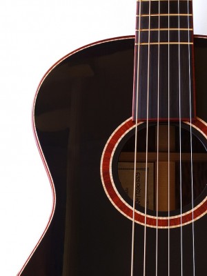

I did a black topped guitar. One of the most difficult parts was photographing it.
Sometimes you have to look at them as "raw material" rather than as something you have time invested in. Your ugly double cutaway sides might be good for binding material or re-bent for ukulele sides.

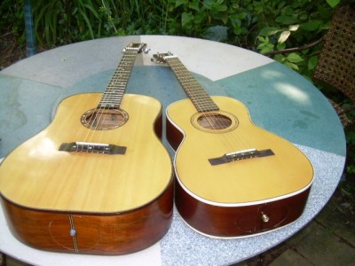

Re: Reject wood guitar? Prototype?
Hi Matthew,
I'll try to post a few pics.
I make them in various models - usually Martin clones. Here is a Dred and a double O. Personally I like the size 1 (not shown).
(P.S. - I also made the picnic table they are sitting on out of Corian scrap.)

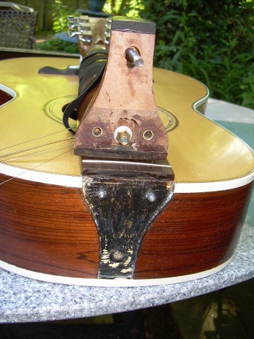

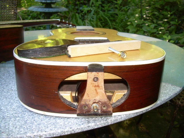

The neck is attached with a single socket head cap screw ( machine bolt) placed in the lower part of the heel which has been reinforced with a metal insert. The block in the body has a T nut for the bolt to screw into (not visible) and two pins mounted higher up to keep alignment. The truss rod is inset into the neck. I started making a neck pocket that is slightly more than the depth of the sides. It allows the fret board to be cut between the 12th and 13th fret and if angled back some can be used to set the action by using a shims (washers) around the bolt.
The body has a "port" in the bottom that is closed by a brace on the inside and a bolt run through the strap button. The end block is wide enough to include the port and has reinforcements glued behind it that also cradle the neck when it is inserted into the body. The machine bolt in the neck is reversed and screws into a T nut inserted into the upper reinforcement. The neck block (not shown) has a pocket that captures the peghead and keeps it secured at the upper body.
