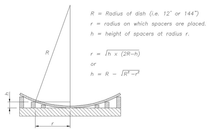

The standard off the shelf radius dish uses a spherical curve where every point in the curve is equal from an imaginary center. You'll be creating a conical curve which is not the same thing. A spherical curved dish allows you to place the top, bottom or the rims anywhere in the dish and the result is the same.Bob Howell wrote: I'VE GOT THE 1/8"MASONITE and am going to make this radius dish. Two sheets, bolt pulling the bottom one down. 24" frame. Any hints for success? Looks simple.
If you go ahead with your design, you can get close to a spherical curve by using an idea I got from Dave Higham on one of the boards, who didn't remember where he got it from, by gluing thin 1X1 square spacers in a spoke pattern originating from the edge of a piece of thick MDF circle going towards the center. Use 3-4 squares for each spoke spacing them about every 3-4 inches. Each square on the spoke would need to be thinner as you move towards the center.
To calculate the thickness of each step there is a calculator here: http://www.liutaiomottola.com/formulae/sag.htm Be sure to convert the "r" to inches instead of feet and use 3, 6, 9 and 12 inches for the as the "L" (distance from the center) figure for a 24" dish. For ex: a 24" diameter dish with a 12ft (144") radius, the outside course (12 in. = L) of spacers would be ~.5" thick, 9" from center course is ~.25 thick, 6" is .125" thick and 3" is .03" thick.
Drill a pilot hole for the center and for each spacer and screw down the 1/8" Masonite to the disc working out from the center. You could put some Bondo or drywall spackling in between the spacers (or more spacers) if you think you need it. The Masonite shouldn't deform that much and average out the force.

I think you're probably right Bryan but as Mark has asked me if I could post the photos here, I will.
They were hosted on *!£§*bucket when I posted the thread on another forum but I never put photos there without keeping the originals myself, thank goodness!
Mark has explained the process so I'll just post the photos and if anything isn't clear just give me a shout.
The formulae. Difference between a radius and a spline curve (exaggerated). Theoretical problem with a spline dish (or parabolic or whatever the hell it is) Raw matériels

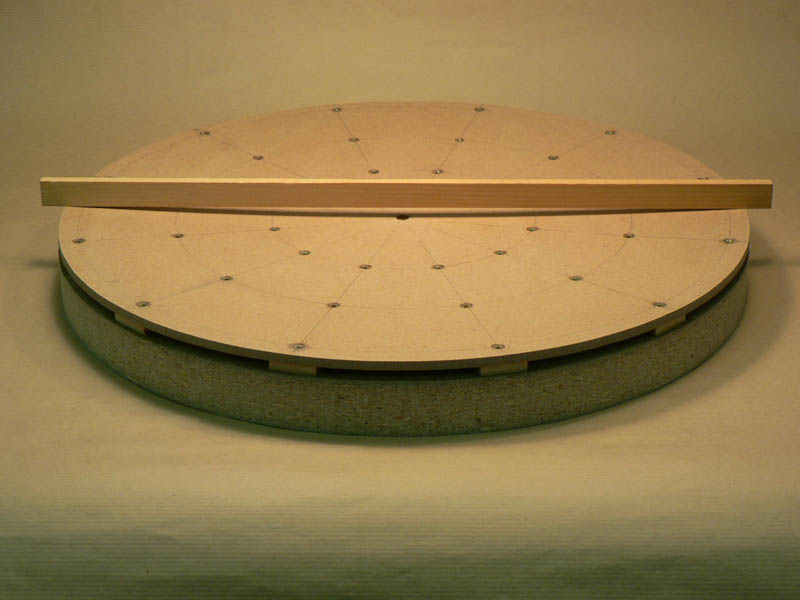

Re: Radius Dish Help
Drilling holes in the strips.
Cutting the strips in half (don't try to cut through the locating pin).
Cut the strips into pièces.
Drill pilot holes in the base board.
Glue the spacers to the board.
- Posts: 97
- Joined: Sun Jan 08, 2012 3:35 am
- Location: Between Bordeaux & the Atlantic. S W France
Spacers all glued.
Screw down the Masonite or MDF or whatever.
