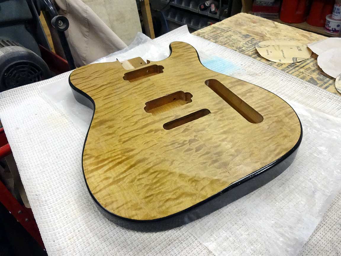

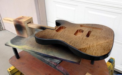

I agree with Barry - something needs to hide the veneer/top interface, whether it be binding, sunburst, or opaque color. I have used the following method on several veneer-top guitars:
-Round over the edge - fill any pits or defects with epoxy - make sure the top is sanded flat
-Apply any dye if desired
-Apply a number of coats of clear finish to the top (I use lacquer)
-Flatten the top - careful not to sand through the clear
-Apply opaque color to the edge
-Sand off any overspray on the top - easy because of the clear base.

- Posts: 3249
Re: no option to delete
Peter, those look great but Jedi is dealing with a fender bass which has very rounded edges so hiding the veneer edge just won't work as well as it does on your sharper edged bodies. Sort of apples and oranges.
- Posts: 1324
I don't think the size of the roundover matters - the veneer/body interface will be in the roundover, and will be hidden by the opaque color, as long as the glue line has no defects. If there are defects, they can be filled, as long as they don't extend into the flat face of the veneer.
