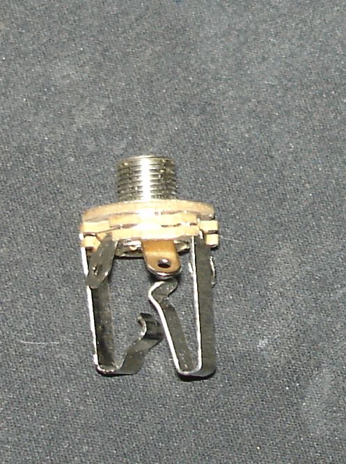

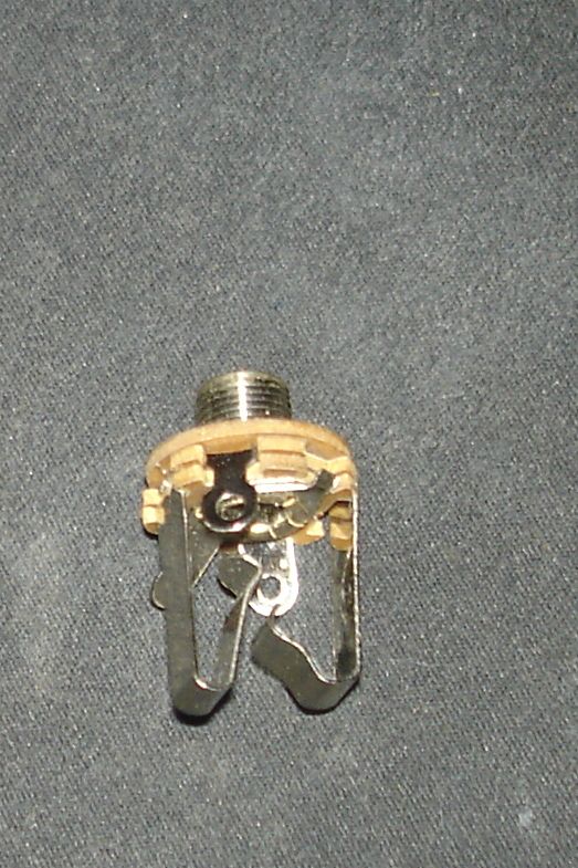

I've tried moving the soldering points around on the jack, but no relief. Could you take a look at my jack and tell me where to solder to what? It has 3 points. One on one side and 2 on the other. So let's call the singular point #1, on the other side #2 will be the one on the left. Hope that makes sense. Picture attached.

Your shield (ground) should be attached to terminal #1 (by your numbering system) and the signal (or "hot") lead should connect to terminal #3.
Re: Help me put my bass guitar back together
I think that is right too.
