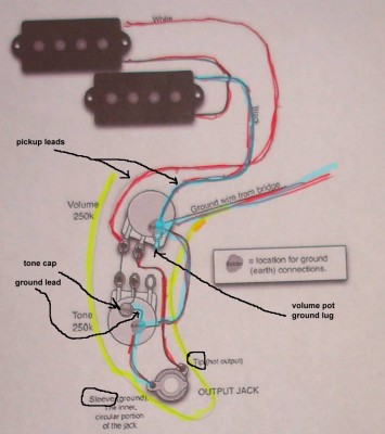

Basically, all the blue stuff needs to be connected together electrically, one way or another, whether through wires, shield or pot cases.

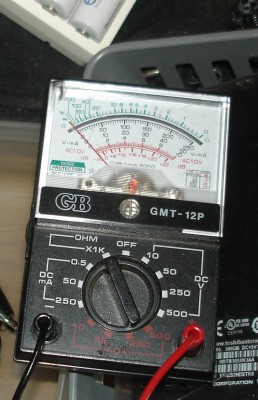

My meter readings now go all the way over. I have posted a picture of my meter so you can see what that reading would be.
I noticed when I looked up "wiring to pots" that there is an input and an output post??? Picture attached. I don't think we talked about that. What would that mean for me?
And I'll still need to know whether to leave the jack wired directly tot he pickups.

Ignore the pot's "input" and "output" - not pertinent here.
Did you wire the pickup directly to the jack? If so, did it make a noise hooked up to the amp when you touched a screwdriver to the pickup? You won't leave the pickup wired to the jack - that's just for testing the pickup.
Regarding the meter, do you mean the needle stays to the left (at infinity) when you test the pickup? If you touch the two meter probes together (not hooked to anything else), does the needle swing all the way to the right - to zero on the top scale?

The meter will be heavily influenced by the volume pot if you measure the pickup in the guitar circuit. You need to detach the pickup at one end or the other first to isolate it. Unsoldering (or cutting) any one of the 4 pickup leads will accomplish this.

The meter was going all the way to the right.

All of the solder points are reading all the way top the right hovering around the one. I think I had a bad solder somewhere I'm soldering them all again.

If you touch the two meter probes together (not hooked to anything else), does the needle swing to zero on the top scale? That is, not beyond zero but stops ON the zero? If not, the meter needs to be zeroed with a little dial that's probably on the side.
If the meter is working correctly, then this is not making any sense to me. Each half of the pickup should probably measure at least 2K, and likely more.

They get a tiny bit to the left of the zero...a hair.

I have the bass back out on the table. I got the meter out and suddenly no readings on anything. My friend used it last week and I guess he changed my settings. I changed the battery, but can't figure out how to get it going again. Don't want to solder something that isn't even alive.

Never mind. I got it going. Looking at page 3 of our postings we are talking about the meter. So I did set the meter at 1K just now and touched the 2 probes together and they did react. The needle went all the way to zero. It's also working on everything.
