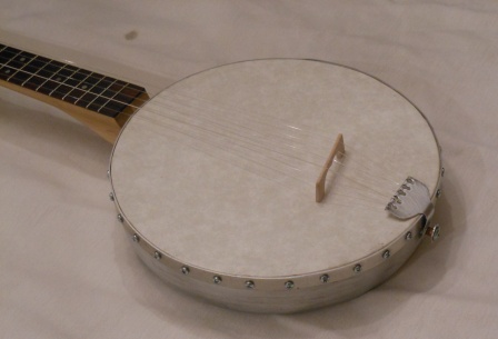

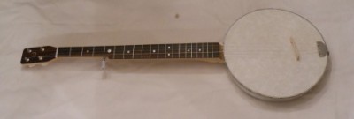

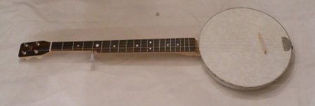

This is a type of banjo I've been developing I call a "Panhead". There are two meanings to that - first, the pot or rim is made from a frying pan or other cooking pan. Second, the head is secured with pan head sheet metal screws - much like a tackhead banjo. This banjo is my second prototype. The first one used a hide head which, of course, tensioned itself as it dried after installation. This banjo has a synthetic head of DuPont Nomex paper, also known as a "Yellowstone" head, supplied by banjo builder and jeweler Mark Ralston.
- Jon Whitney
- Posts: 170
Re: Jon Whitney's backpacking banjo

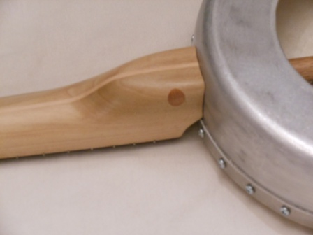

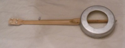

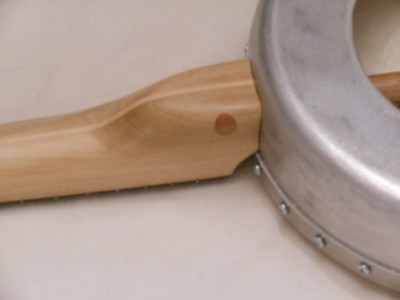

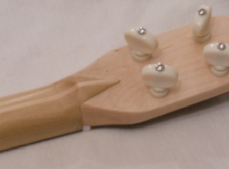

I made the neck from poplar for lightness, with a 1/8" center lamination of hard maple for strength. I figured with nylon strings, it would be strong enough. I also chose to use ukulele friction tuners for cost reasons as well as weight reasons - they allowed me a thinner peg head. This is also made from maple, joined to the neck with a V-joint. The peghead overlay and the fretboard are Rosewood - but I kept the fretboard very thin (about 1/16") to reduce the weight. The inlays are cut from an old CD. The neck is held to the pot not only by the dowel but also by two screws through from the inside into a dowel that runs across near the bottom of the heel.

Jon, looks good. Are we going to be graced with a sound sample? Also a question about the Yellowstone" head. You mentioned that real hide heads self tension as they dry, what about the "Yellowstone"? How is it tensioned on this mandolin? Also are the panhead screws straight through the head with now washers or rim or...?

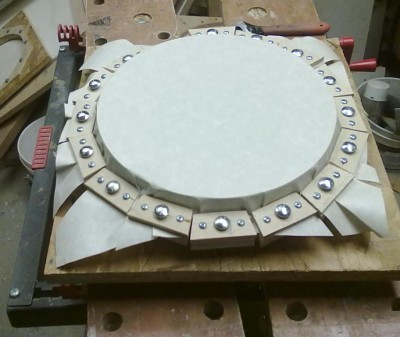

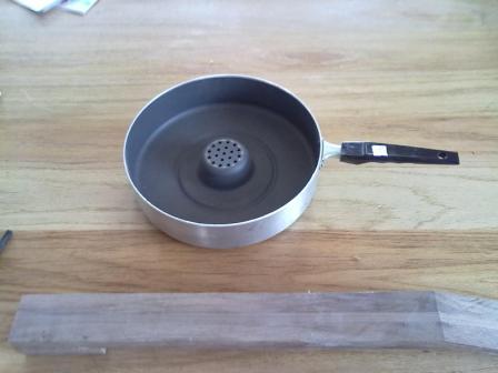

The head material is not at all elastic. It is much like Mylar in this respect. I had to pre-tension it by mounting temporary blocks of wood around the head, with bolts through them down through a plate at the back of the banjo, and tightening the bolts to the desired tension. Then I wrapped an aluminum band around the edge, and put in the sheet metal screws through the band, the head material, and the aluminum frying pan rim (pre-drilled holes in the metal) to hold the head tight. Then I trimmed the excess material.
I will be probably building a few of these for sale but I intend to take this one backpacking this summer. I forgot to mention, the total weight of this banjo is a hair over 2 pounds (less than 1kg for our rational, non-American friends). As for changes, I think I will try using more tensioning bolts to try and eliminate any puckers (there are a few minor ones on this banjo), and also epoxy between the head and the rim to make darn sure it doesn't slip out. I also have a strange cooking pan that has a cone coming up in the center which I think I'll leave as an internal resonator and see how that sounds on the next one.
