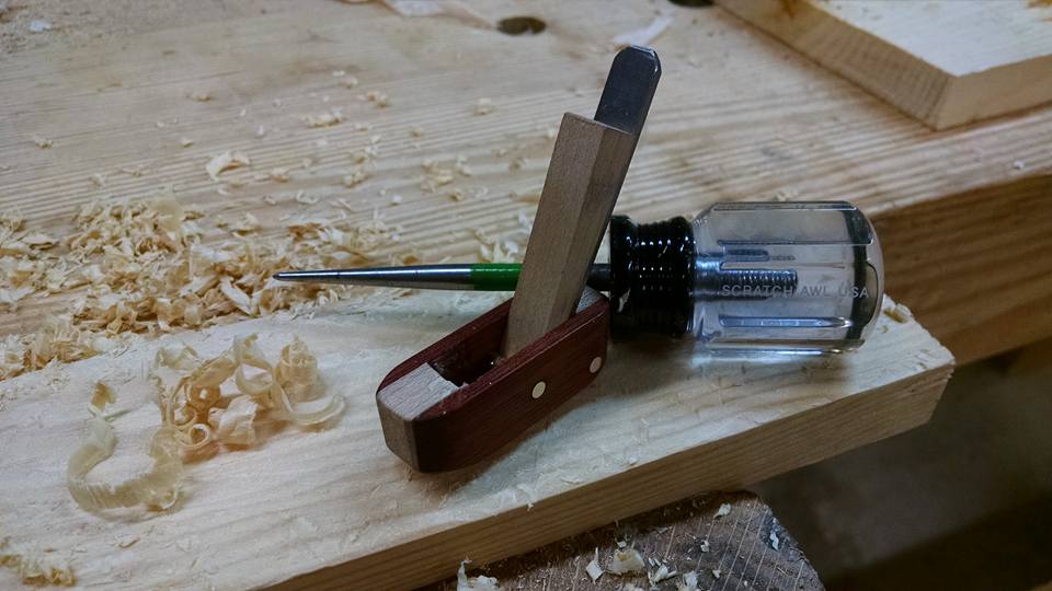

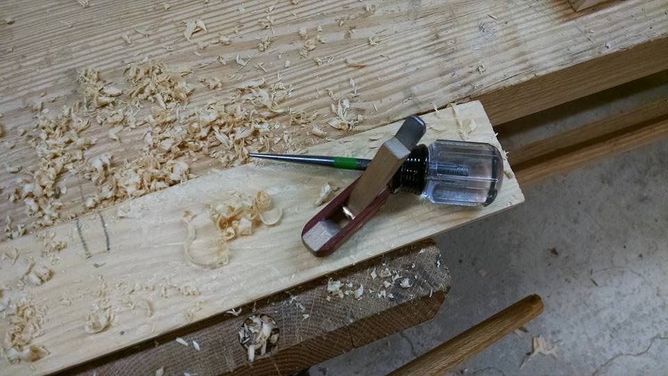

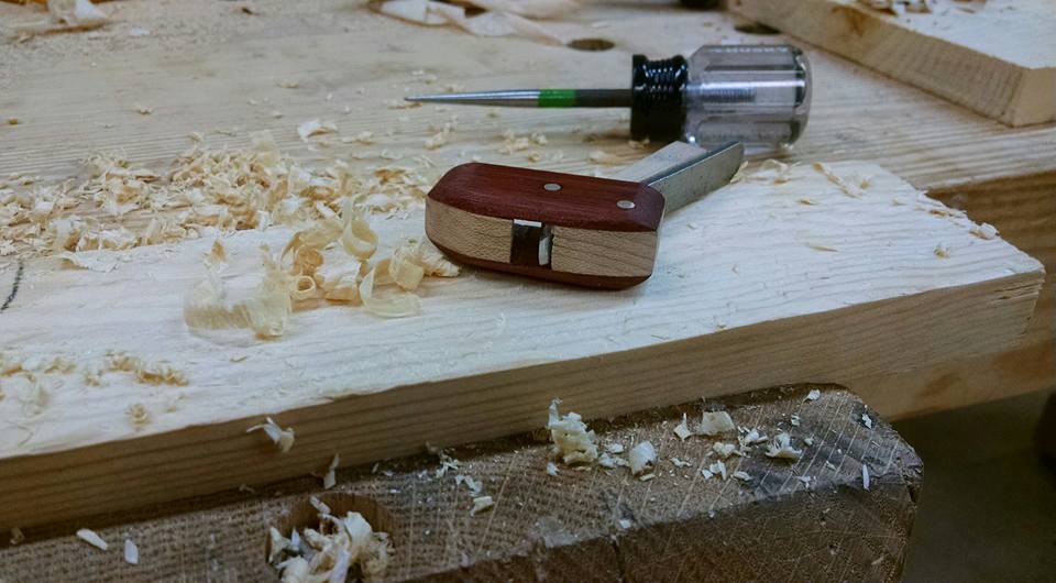

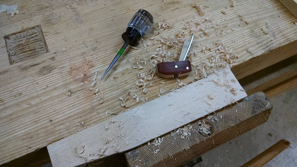

The 8mm plane is done. It's curved in width and length. This one is pretty high angle, 60 degrees, though I sanded the tail end to pitch it a bit lower. Also making a 45 degree body for it.
This one tends to jam up, hence the awl for clearing it.
I've never used tiny convex planes like this before, so there's some learning curve to overcome.
(Eh, the photos are in reverse order of the way I wanted them, look at them from the bottom up!)
Bottom view.
Bottom view.
Side view.
Side view.
On pine, sitting in the nice hollow it made.
On maple.
On maple.

Smooth off the "cap" for the iron so the chips don't catch on it. The chips need a smooth path to exit the cutting process.
For such a steep angle you need a really sharp cutting edge, and you basically have a scraper plane. You're off to a good start, and you will learn a lot by making lower angle bodies and using them.

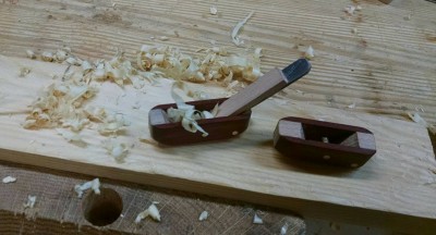

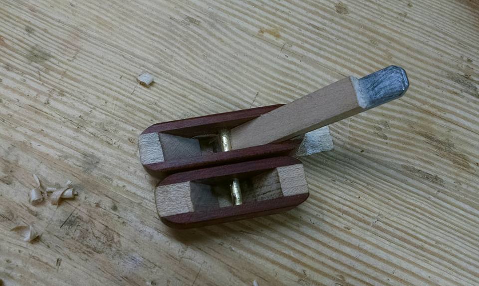

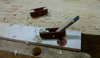

New body with 40 degree bed angle works MUCH better.
Shavings come out warm from friction, but unlike metal bodied planes, these wooden bodies stay cool to the touch. I'll probably get a bit of a hand cramp gripping these tiny things, though. I can actually use them two handed for easier grip, at front and back.
New and old body, with lovely little pine shavings.
And on maple, just as nice.
Top comparison. New one stays nice and clear of shavings.
