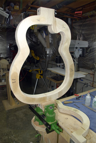

Just a few highlights in terms of how I use outside molds to hold and jig the work:
An outside mold is a frame to hold the rim, and that frame can be clamped into a repair vise to allow access to both sides for linings, tapes, detail cleanup work, etc.
By blocking the mold at a uniform distance off a true surface such as a flat bench top, the neck and tail block can be installed square and true without much in the way of bother.
Storage of the rim is a lot easier...drill a hole and hang from the rafters using a ladder bracket...
When the box is closed (this is an archt. getting closed), the mold stays on and keeps the sides from distorting...the spreaders are either rem,moved through the sound hole (on flattops) or spruce springbars are substituted, then cut and removed through the F-holes.
Another criticism of outside molds (beyond time and cost to fab) is storage...I have lots of open rafter space, so no issue even where I have 2 or 3 of the same mold (people love those SJs...), but broken down, they really don;t consume all that much space.

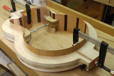

I started my tool / jig building first with a solera. After doing some extensive research, and listening to the guys on this forum, I changed directions and decided to go with radius dishes, outside frames, and a Go-Bar Deck.
The outside frames were pretty easy. I used 3 layers of 3/4 Baltic birch plywood. I used a band saw to cut the shape out, being careful to leave the cutout piece of wood intact, for making the bending mold.
I also built the Go-Bar-Deck using 2 pieces of plywood, 24 x 24. Drilled holes in the corners and bought some 5/8 threaded rods, long enough to hold the top high enough to glue the box together. I used wing nuts and can also lower the top low enough for gluing braces using the same rods.
