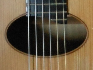

Allen, This one has a dark and light line of edge banding around the soundhole. I agree, I,m not a fan of large rosettes. Here are some pics of the details.

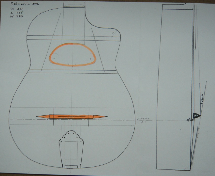

Re: Doing the "crease" for a Selmer-Maccaferri model.
Thanks. First draft of my Selmeroïd contraption. First attempt to send a photo too.

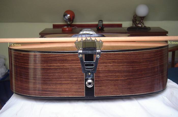

I went yesterday to the Maurice Dupont showroom near Opera Bastille, here in Paris. Nice shop. To my surprise, not a single model in the shop presented a crease or pliage. When questioned, the shop leader (I suppose he is a good level M. Dupont's assistant luthier, since he is in charge of much of the maintenance, for the now distant Cognac factory) said to me that they gave up the crease or pliage thing a long time ago. I quote " No noticeable difference in the results and a source of problems for the over all resistance of the object". I add that It is true that such guitars are often treated on the very "muscular side" by their owners, when in the tradition of Django's epoch particularly. They only do it when the customer insists.
The dome of the soundboard does not exceed (visual appraisal only) 5mm. For the large mouth, I could see a reversed top, the strutting is quite similar to the old Selmer reference. Also visual appraisal only.

As long as your arch is not too severe and top too thick, you should be fine without a crease. What is too severe and too thick? No red line, but roughly 6-7 mm of arch (camber) and 2.5mm on the top would be roughly the upper limit. More arch than that and/or more top thickness, the force needed to get the top down to the tail block after crossing the lower arched brace(s) will overcome the arch in the braces. Modest arch and thinner top, you'll be fine.
Bending the cutaway into a solid wood side is doable, just practice on scraps until you get the right combination of heat and bending force. Thin the wood a little (1.8-2.0 mm) at the most severe bend and maybe even boil that end in water for five minutes first.
If you laminate, I'm guessing you might have trouble with 1mm plywood. I have laminated with 1mm solid wood and it works, but it is right on the edge of breaking at the cutaway. Plywood might be even more difficult, but a few tests will prove that quickly enough. Building laminating molds for a one off is a lot of work. Bending solid sides over a hot iron is quick and effective.

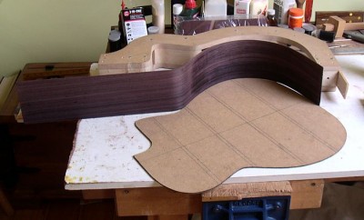

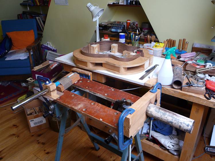

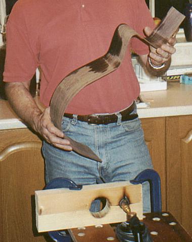

Hi Alain, for what it's worth, just a note to say that the tight bend for the cutaway was quite straightforward to bend, taking things slowly, using East Indian Rosewood and a narrow heated pipe (a piece of shower curtain rod).
It's worked 3 times so far. The only problem I've had on the tight bend was trying to bend ebony binding, which just didn't want to bend, just snap.
The side thickness was 2.2mm and soaked in a bath following the Cumpiano book. It was a relief to see it bend without any drama.

The side was soaked in a bath for about 20 minutes. During that time I added a couple of kettles of boiling water to keep things warm.
