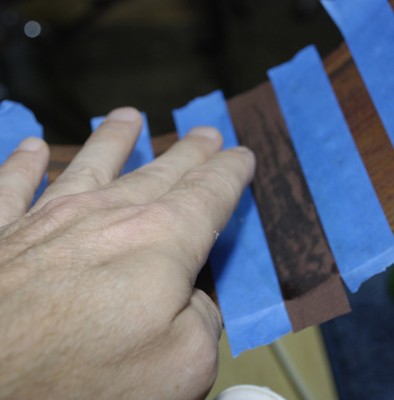

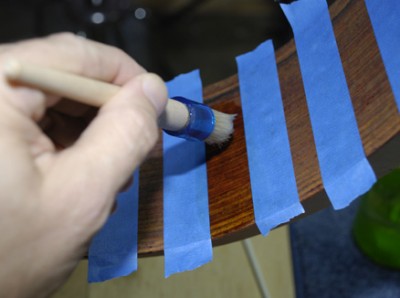

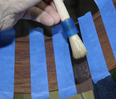

Wright cotton/poly bias tape in Seal Brown or Mocha Brown is what I use...a couple bucks at Walmart or a fabric/sewing supplies store...I iron the stuff to flatten it ou, trim to 5" lengths, then use a rotary cutter to cut to final width (about 5/8" - 11/16"). Martin tried a PSA-type tape to save labor and it did not turn out well.
I trimmed a couple shots from the photo essay...here in the opening shot...the tape dams are applied, the dry tapes are laid in a bed of fresh, hot glue, then patted/screed with paper towel soaked with hot water...pat the tape down after the excess glue is dry, pull blue tape off, and carefully clean any residual glue off the adjacent wood surfaces.
Once the dried/now hardened tape is dry, lightly sand edges with 320 and glue in linings over the tape. When all is dry and profiled, apply a coat of 1 lb cut shellac to protect the surface of the tape...if you get a little sloppy, just use a razor blade scraper to clean up any errant shellac. The single shot of the completed rim shows typical look of Seal brown tapes on lighter side woods...also an option to use whatever color works...black or tan would be decent options. Look inside vintage Martins and some other quality brands and you'll see essentially the same approach, although usually a cotton sateen, silk, or similar material used. All this takes far less time to do than talk about.
Also...once I have a tape layout done for a particular body, I take a 1" wide strip of maple veneer and transfer the locations with any notes...tape the ends with blue tape and punch a hanging hole...usually put the full side layout (including sound port location, which gets wider tapes over the mahogany transition ramps to the side doublers) on one side and the cut side layout on the other (if they vary...they usually do).
